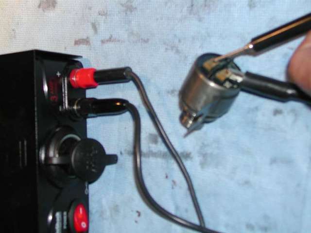

It is located on the vb itself you have two solenoids one for od and one fot the tc the one for the tc should be silver and the od one will have a black cover. to do this you will have to drop the pan you will be able to see them then you need a voltmeter to check the ohms i need to look up the specs you can take the tc solenoid out and test it with the battery. on the prongs hook a jumper from pos to one of the prongs and neg to the other prong and you should hear it click. You also might want to look at the top of this page at the stickies at the a4ld vb rebuild that has a lot of pictures.
It is possible that the screen is blocked. Here are some pictures from Glacier991's photo gallery. The first one is the "click test" that Toy just mentioned:
