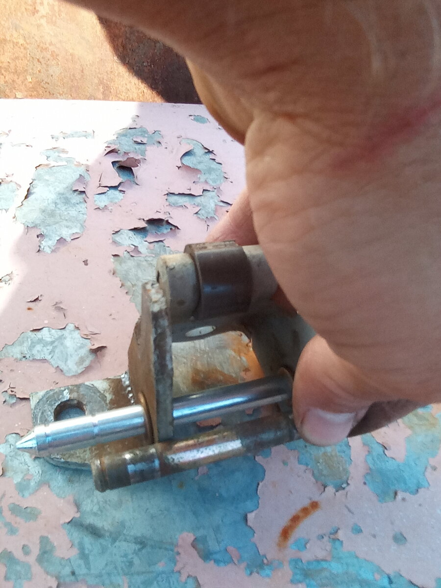

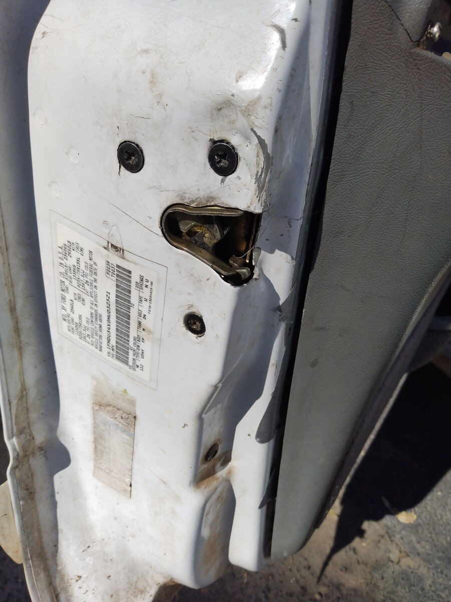

I was using the slam and lift up on door trick for a bit on my Explorer.One day besides being super hard to shut it would stay shut lol.Many days later I up and started replacing the door pins top and bottom and doing some othe stuff. I now have a door that shuts and stays shut( no undue slamming). For some reason the pin on the door frame was hitting the top latch on the door so I was trying to close it with just one part of the latch mechanism closing around the pin. I did not know this until I started removing the hinges. I decided not to remove the door completely because of all these wires , power locks etc. I unbolted the door to the thing assembly and took the pins out.

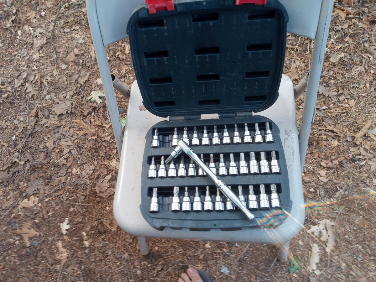

Heres some pictures. I put the new pins in before I put the on tye door. Ha ha went to put them on the car and bam realized my mistake.

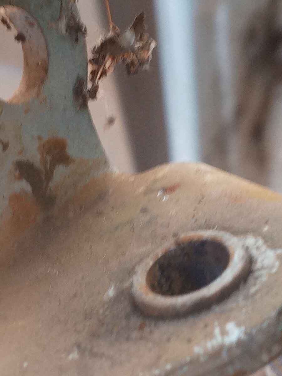

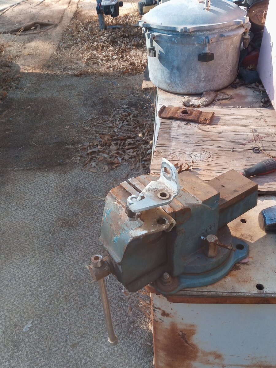

I used a thick washer and spaced my pin out from the frame so it didn't get hit by the door. The door wasn't closing. I also hit the pin to bend it down. I supported the door with a folding chair and some shims. I got one bolt or two bolts started and then shimmed it up higher because the two bottom bolts weren't lining up.

What's the beverage and who makes the pressure pot?
It's Rade Ale it's from Reno Nevada. I don't know what pressure pot your talking about. Oh I see the pot in my picture. I don't know the story of that thing lol. My dad has a lot of random stuff. However my mom used to use one at her house and they are pretty cool. They can really slow cook stuff, I have not seen one in action in a long time.

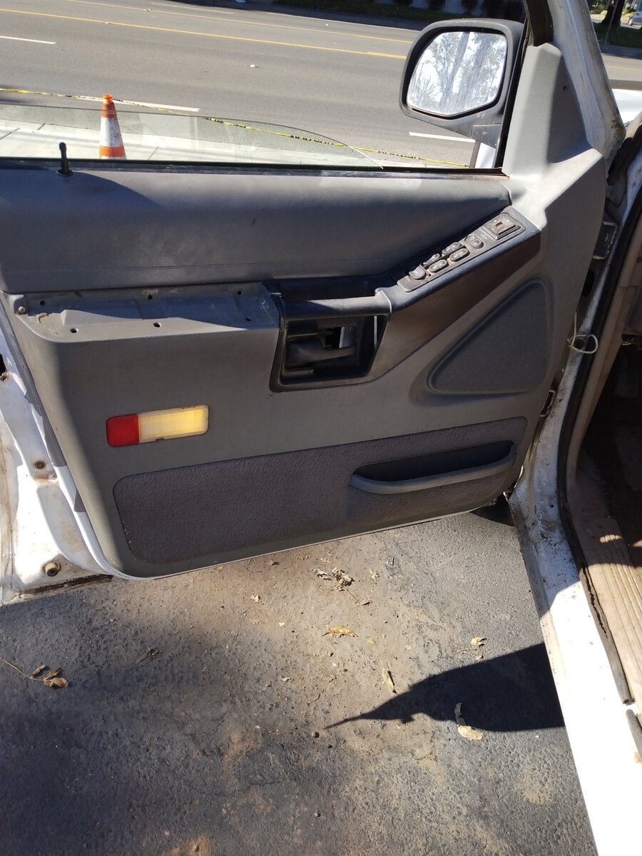

Went to the junk yard and was going to get a whole door and bolt it on. I was happy to find out they had just got a first gen in. It was the same as mine in most ways. The price for the door was about fifty dollars more then I was hoping for. The door was red and mine is white. I ended up pulling the latch mechanism off yesterday. The one I had was not staying clamped very well. I also grabbed the door handle and the side panel. I got it installed and hooked up today. The outside handle now barely wants to do its job but I am satisfied. Right now it is working but I had to bend the striker pin a lot. I think I need to adjust the for where the hinge is but I took the quicker and more straight forward approach. I might end up pulling the trany to to see how good it looks.
