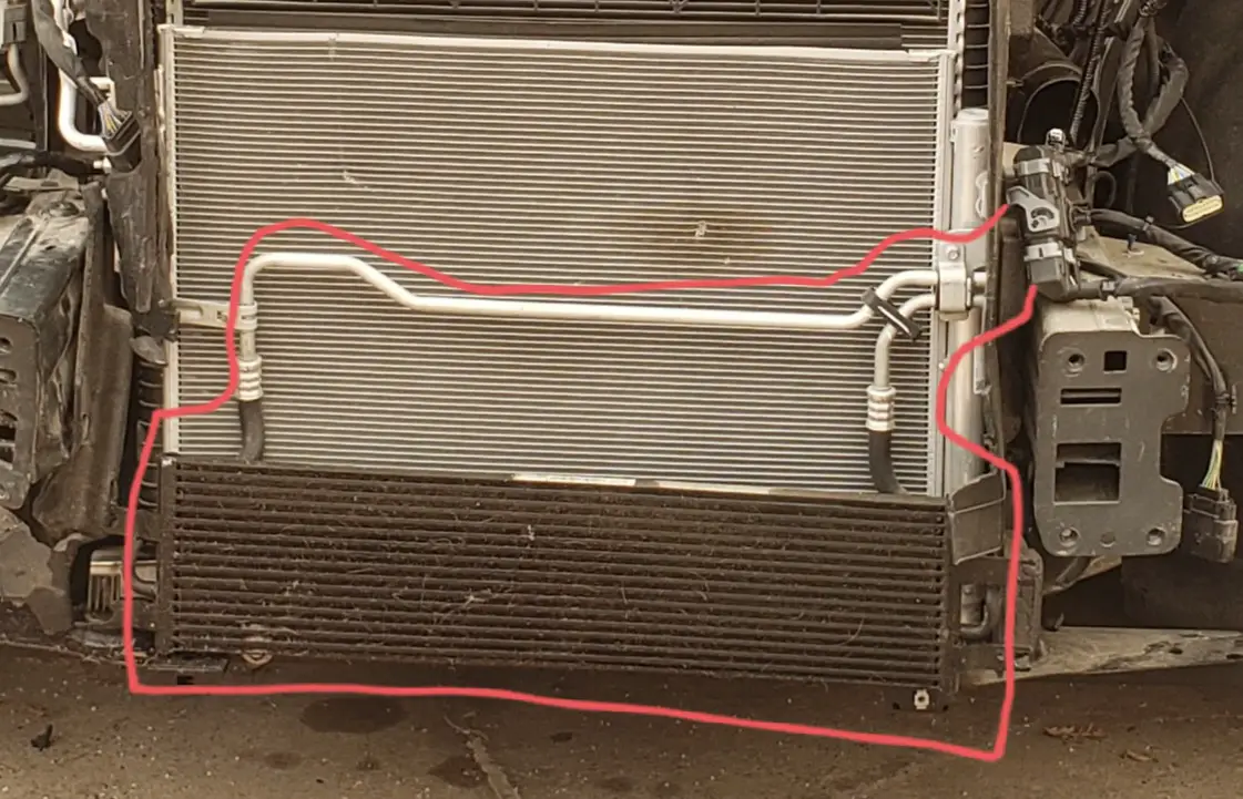

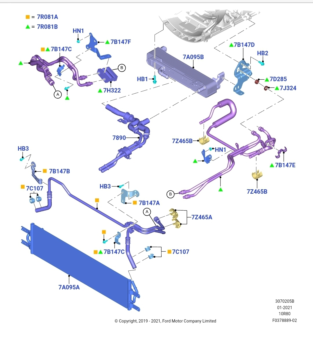

Thanks, folks. On the transmission cooler issue, I was referring to an auxiliary cooler in addition to the system all automatic trans vehicles have, in my experience, that runs the fluid through the lower part of the radiator.
I guess on my 2020 PIU it comes standard, but I needed to replace it so was able to order from a dealer w/o a problem.
It is separate from the engine cooler radiator. In fact it's sitting in front of it, on the bottom(see pictures). Mine for some reason was painted black.
