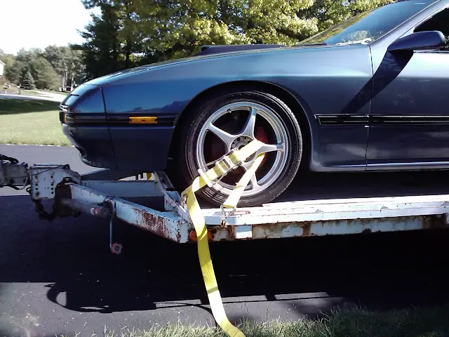

With my 2006 EB I towed my Mazda RX7 (converted with a Chevy 383 Stroker) on a 14ft tandem axle trailer with surge brakes. Approximate total weight is 4700lbs.
I have the 4.0 with 3:73 gears. I had a class 3 hitch installed underneath the OEM class 2 hitch.
I trailered my car for an annual car club event this past October. From southern Wisconsin to Indianapolis Indiana then straight to Cincinnati Ohio (Great drag strip called Edgewater) and then back to Indianapolis in one day. Then back to Wisconsin 2 days later.
I kept the trans out of O/D the entire trip. Approximately 3000RPM at 65MPH. I got 15MPG the entire trip with having the A/C on intermittently.
The Explorer ran fantastic and had no problems. (I had 68,000 miles on the odometer at the time)
I change the trans fluid every 30,000 miles.
Use common sense when braking and accelerating. Don't expect it to pull like a diesel and you should be fine.
