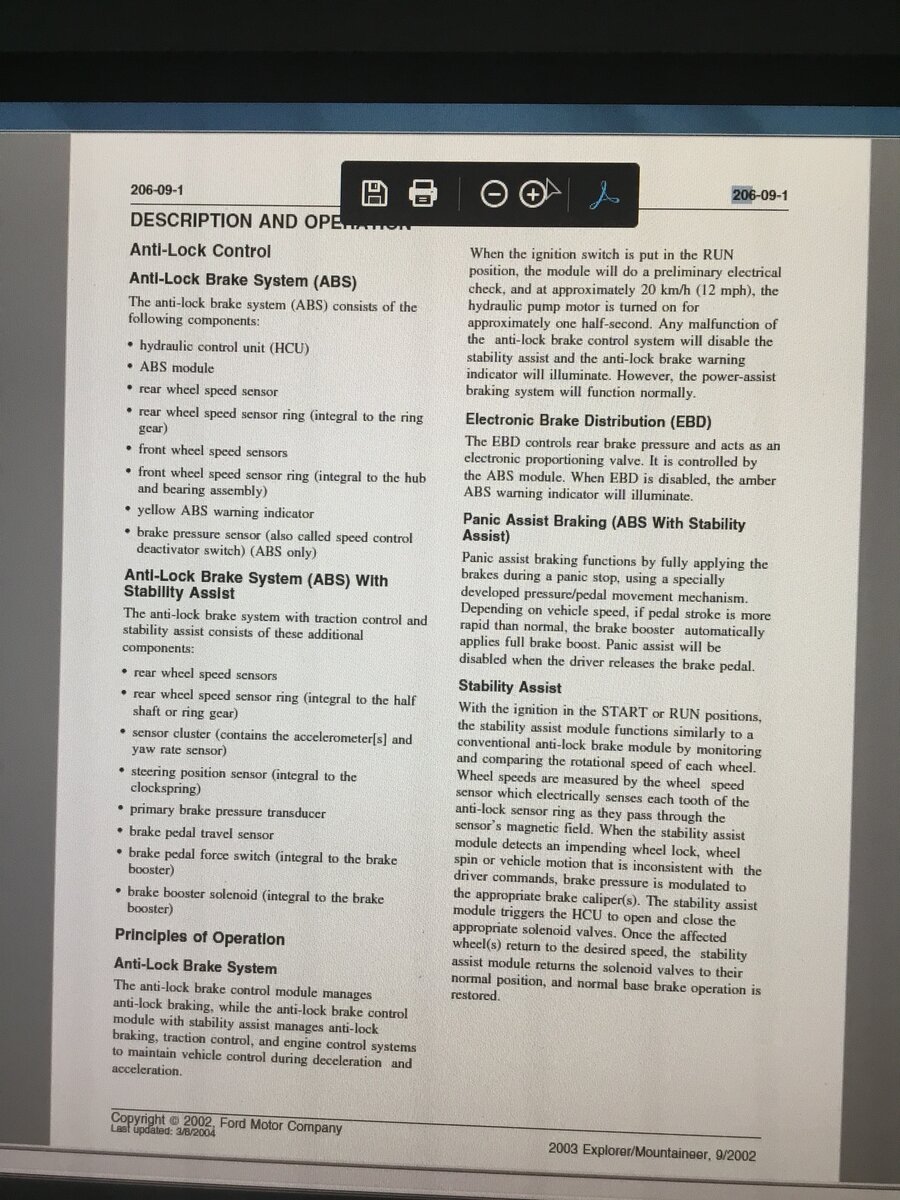

Not normal as per the overview from Ford manual attached. There are at least four different fused inputs to the ABS/IVD module and only removing fuses seems to disable abnormal activity on my misbehaving Advancetrac. Mine sends Uncommanded brake pulses rather than affecting the engine power. FYI I changed out the entire hydraulic control and the logic module on mine ( 2003 Explorer) and it still sends Uncommanded brake pulses.
