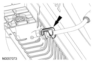

I was driving Bull Canyon this weekend and my trans cooler line disconnected and leaked out the ATF. I was stuck at the bottom until an ATV took me into town to get some fluid. Luckily I had some hose in the bed from doing a seafoam to the engine, because there is no trans fill tube. The trans took about 6 quarts so it was more than half empty. I'm going to do a pan drop and replace the filter this weekend since the gas station didn't have Mercon SP. Overall I'm actually impressed by this 6r60 transmission with 80k mi, because I was able to refill the trans and continue the 330mi trip to Flagstaff, Grand Canyon, Four Corners, and back to SLC with a full bed of camping gear doing about 80mph.
Question: since the cooler line came off and I was able to get it on and drive the 330 with no leaks does that mean I'm ok, or is there some type of o-ring or fitting that needs to be replaced since the line came off?
