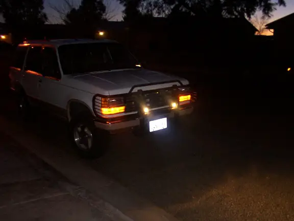

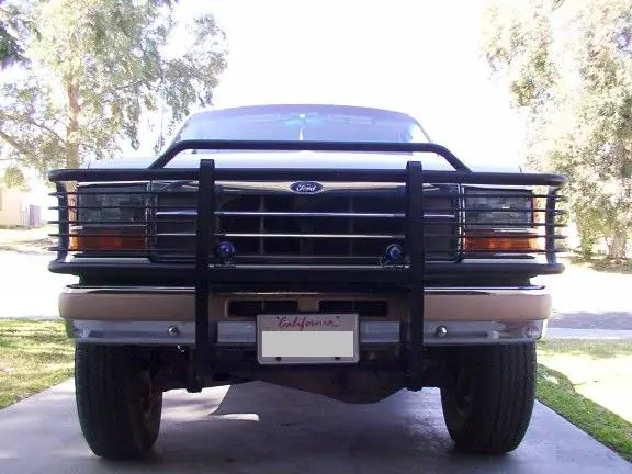

This is a pic of the push bar Sidewalk hooked me up with. It also has a set of Pilot projection fogs and is waiting for a set of KC Dayliters.
Here is a pic of the bar with lights on. It will look much better and work better with the KC's on there.

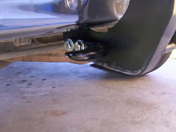

This is the last major thing to do with the pushbar. I finaly got around to adding my tow hooks. This is a pic of the passenger side hook. Both are fastened with 1/2" grade 5 bolts. The pushbar itself is fastened to the frame with 3 1/2" grade 8 bolts on each side.

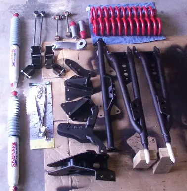

I will post more pics later on this weekend. I will be putting on my 6inch Skyjacker lift with a SOA for the rear.

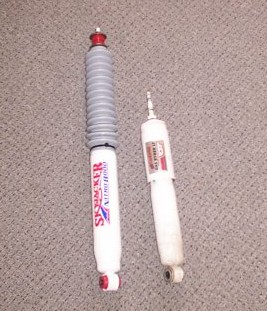

Just a little comparison for you all. Here is a picture of my Gabrials next to my Skyjacker 8000's for 6" of lift. I knew they were bigger when I picked them up but next to the stock size OMG they are big.
you mounted your tow hooks to your brush guard drop brackets? I dont think they will hold the weight of pulling your car... but just my opinions.

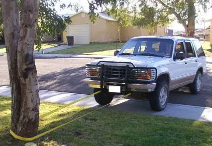

Here is a pic of me testing my tow hooks. The old girl was giving it her all and nothing broke. So it is my best guess that if you get stuck harder than that tree, your not going to be pulled out anyway. Nothing moved, bent, groaned, or broke. While my wife stood at a safe distance to take the pic and warn me it anything started to give.

Trust me youre not gonna find out if your tow hooks are strong that way. :) I found out for a fact having the tow hooks mounted into the frame isnt a good idea. I was getting tugged out of a stream while 4wheeling and ended up bending the frame a bit. I hit the other tow hook on a rock which bent the frame rail on the other side. Once i get some cash im gonna remove those hooks and get a front reciever.

Well it didn't get lifted this weekend. It took about all day just to get the final parts that I needed for the lift. So, I did my brakes today and that took forever. Was like everyone and there brother was there turning rotors and drums. I got those new ceramic brake pads for the front. They seem to work really well. I will have to let you all know in about a month if they are worth the money.
The only thing I did get done that has to do with the lift is, I repainted everything. When I picked it up DB_1 had already sanded down one radius arm, and the other had a nasty rub spot from his tire one it. So the wife roughed everything up and took off what little rust she found. Well here is a pick of what it looks like now. I am going to go thru and hit everything with semi-gloss black once it is completely dry. Sure beets having all that red under there.

It looks like your Explorer will be the one to watch! I can't believe you're going w/extended radius arms, and the whole works! Your Explorer will be all that!!!

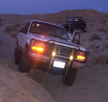

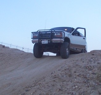

Well, I got the picture problem fixed with some help from people on the board. Now you can see what I am posting. As for the truck, my niebor and myself went wheeling right close to home just to test out the truck. Here are a couple of pics of my truck. Hope you all like it.
