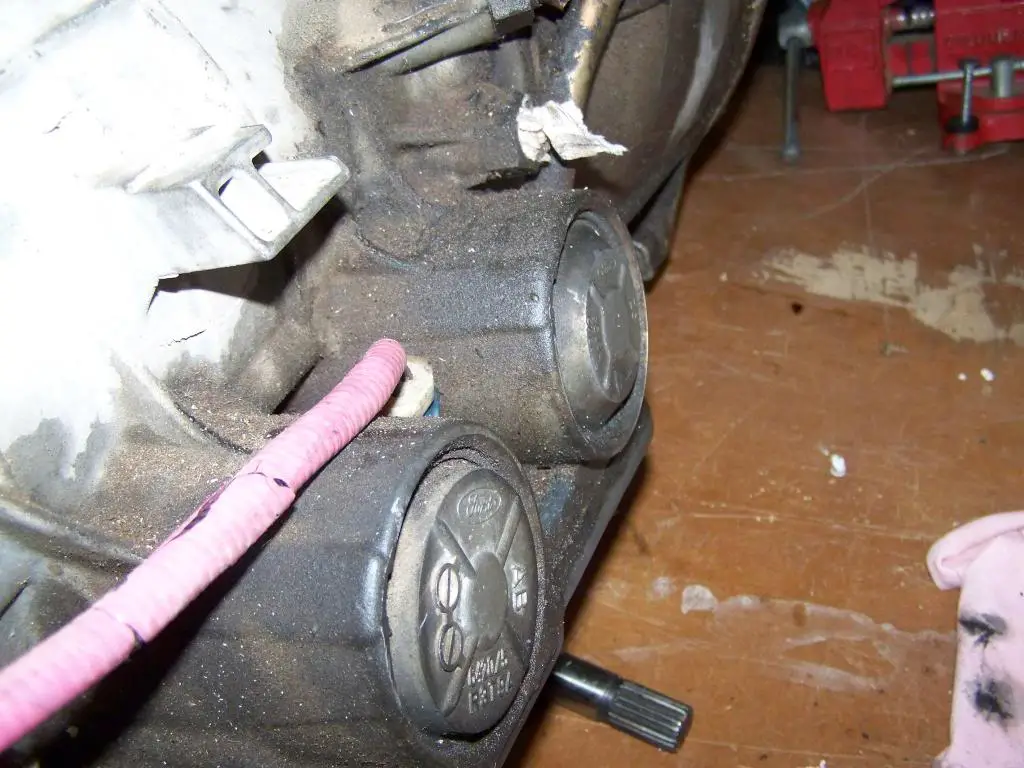

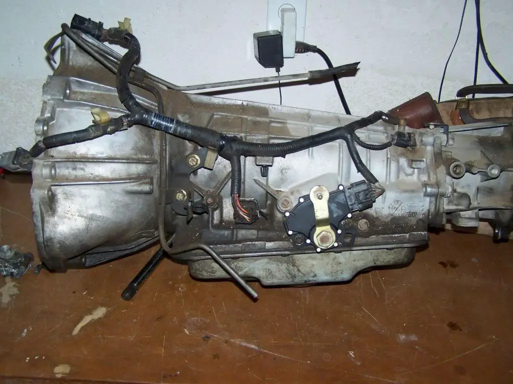

Have a question to whoever knows the answer: This is the 5R55E transmission that I got from the JY, does it look rebuilt? I think it might be just because of the blue bolts instead of the stock blue ones, and the black caps in a picture I provided are switched around. What do you think?
Does it look rebuilt?
Does IT??????
Would love it if somebody knew. I heard the blue bolts were considered stock, but i'm not sure. Dont wanna be a stuckup idiot that's asking to be spoon fed either, just not patient with an answer. :)
