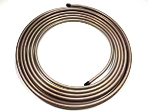

Those are the transmission cooler lines leaking. If you can follow them up to an area that is solid on each side of the damaged area you can cut them out and use some new steel lines with compression fittings to repair. If you use rubber line to make the repair just be sure it’s rated for transmission fluid. Try nickel plated soft line to replace them
Shop Roll of 3/8" Copper Nickel Fuel / Transmission Line​
And union fittings
as it’s easy to bend and form to original line aluminum tubing is also easy to form. Trying to replace lines from radiator to transmission is almost impossible unless vehicle is on overhead rack.
