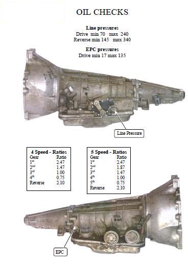

Welcome to this forum! Is there a check engine light or a flashing overdrive light? It sounds like the hydraulic pressure is low. Check the main pressure, and the EPC pressure with a 0 - 300 PSI test gauge.

How do I go about checking those pressures? Is there a how to or is Google my friend :)

Parking break seems fine in just Rollin resistance. It wont move under idle in any gear. It takes fuel in all reverse included. Still no cel or overdrive light. Transition fluid looks and smells as it should. Time to check pressure, I read the how to, however I didn't find the pressure at which each gear should be. Looks like it's time to use that search button. Although I will say I'm getting closer to yanking this think and putting my m5r1 in it.
This diagram should help:
