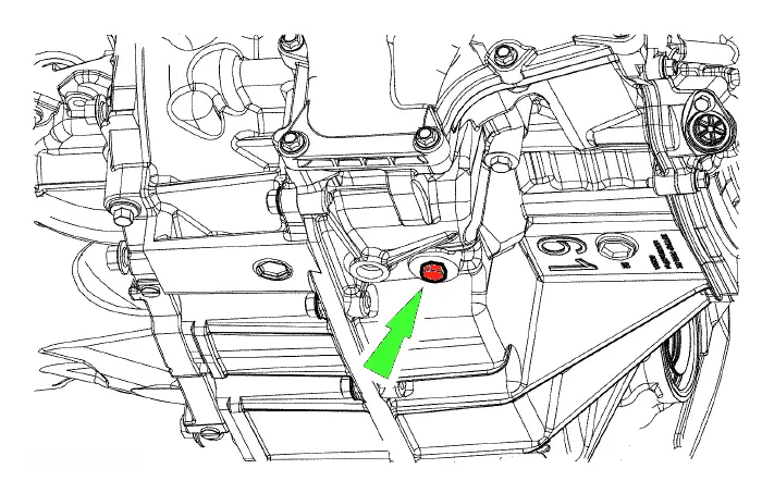

I tried looking under the car to see if I can find a drain plug of some sort but I'm not sure if the bolt I found was a drain plug or not.

There is a small drain plug at the center of the transmission on the bottom. I mean small.

Also, thanks FordGT55 for the picture! Do you happen to know the torque spec for the bolt as well? Thanks!

I would torque until snug like a typical drain plug. And make sure to get twice the fluid(10 or so quarts) you would need for a drain and fill so you can do one, drive it around and then do second drain and fill to get most of the dirty atf out.
