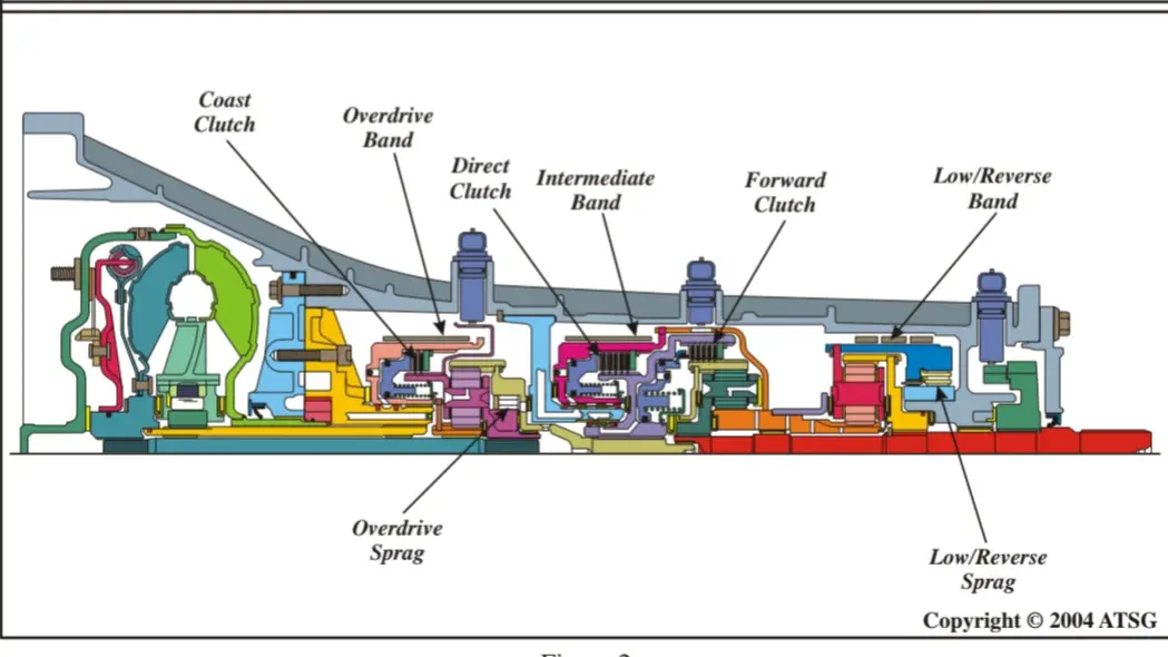

That's crazy that someone would remove an engine to fix some leaks. Lol to each his own I guess. I'm honestly hoping you meant to say they removed the transmission. Anyway... you have to remove the transmission and break it completely down on the inside to get to the reverse band because the reverse band is all the way at the back, inside the transmission. I would not suggest you try unless you have rebuilt an automatic transmission before, or you're just extremely good at taking things apart and putting them back together. If you do, I recommend you download the technical service manual. Click here.

I mean, I guess I should have worded my response a bit differently. You can completely break down the entire transmission without removing it if you have the engine out. But with the engine already out, it would just be so much easier to just pull the transmission out if your going to go into it. So, technically, yes you can pull any band you want without removing the transmission if you have the engine out, but if it were me, I'd definitely just pull the transmission and get it on a table or something where you can easily work on it. But again, to each his own.
