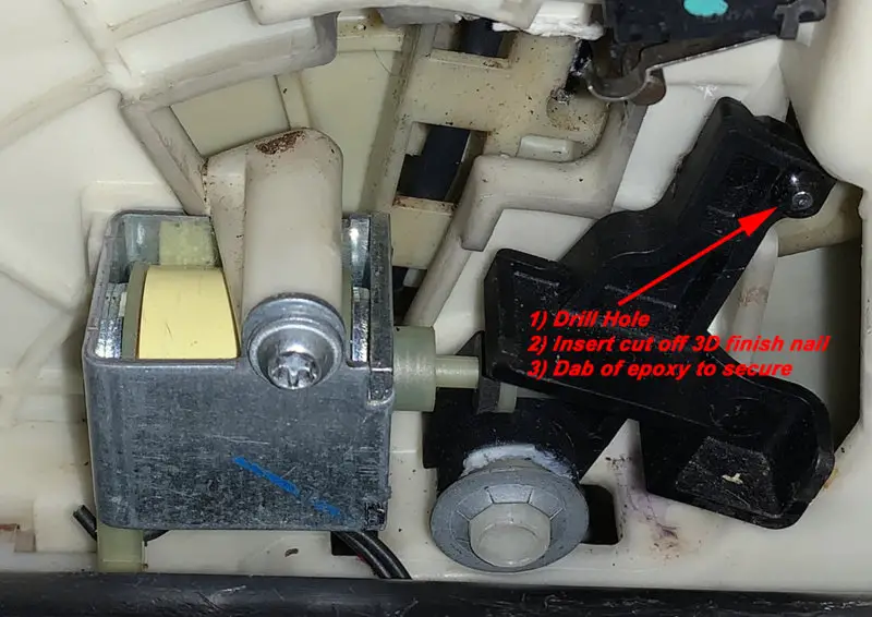

Posting this in case you want to temporarily bypass the brake transmission shift interlock if the module fails and you need to drive the vehicle.
This works with Gen II Sport Tracs and 2006-2010 Explorer/Mountaineer.
