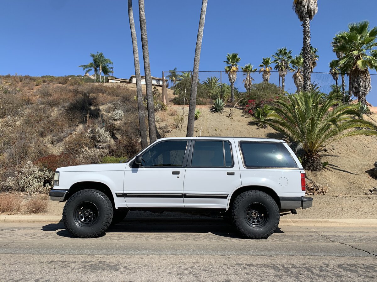

I've owned about a dozen 1st & 2nd gen Explorers over the last 8 years. I've done Dana 44's on a 1st gen, coilovers on a 2nd gen, uniball uppers, leveling kits, lift kits, fabricated a handful of front ends, shock hoops, bedcages, the list goes on and on. For my latest truck, I began my search towards the end of last summer & actually started out looking for a 2nd gen, (I really like the ones with the AC in the center console). Thankfully this truck was not needed as a daily driver, so I was able to take my time. I happen to stumble across this extremely clean 1st gen that reminded me so much of my favorite Explorer, which was also a white 94 with black wheels. I could not pass this truck up. Here in Southern California, these trucks are getting very, very tough to come by, and this was one of the cleanest 1st gens I have ever seen. Here are the specs:
1994 XLT
218,000 miles without a rear main leak, signs of a power steering leak, mostly clean oil pan & block, clean rear end & under carriage
4x4 - A4LD - Pushbutton 4x4 - Stock auto hubs
3.73 Limited Slip
Full power seats with lumbar & bolsters
A small additional lower exterior trim piece that seems to not be too common
31x10.50R15 Toyo AT knock offs on Pro Comp Series 51 steelies
Kenwood Deck with a pyle (o' ****) sub in the stock location
I'm 9 months behind on making this thread, and I have done A TON with this truck, so stay tuned for a lot of catching up!!!

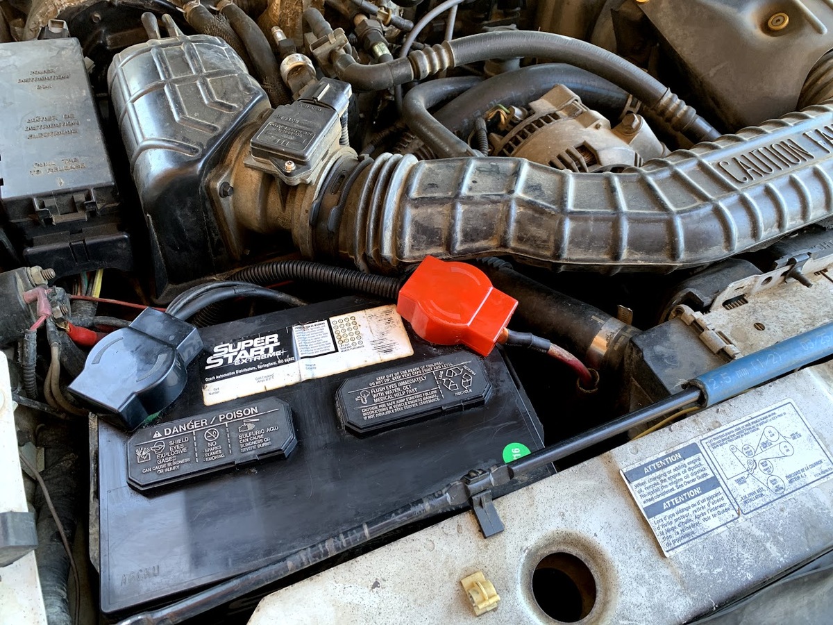

My son was due for an upgrade. He is such a trooper and can do 12 hours offroad with minimal complaining. He deserved it! Also threw in some military style terminals.

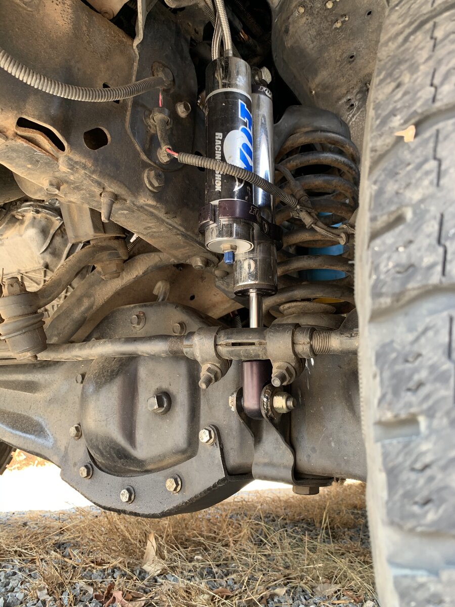

Seriously! The brakes are horrible, & especially with how hard I drive

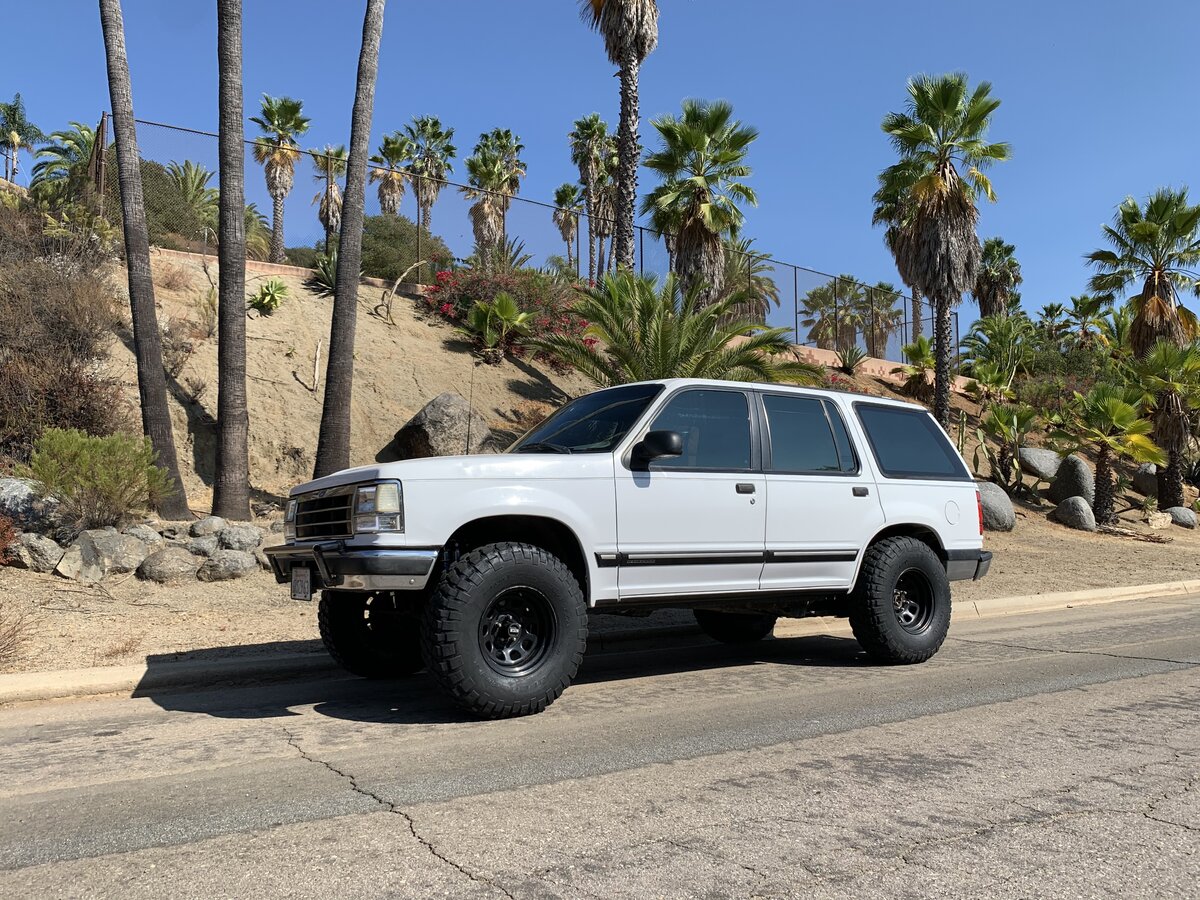

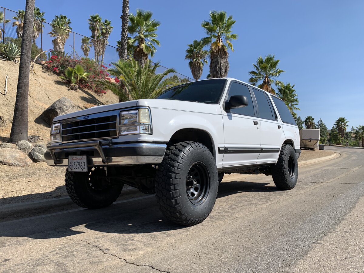

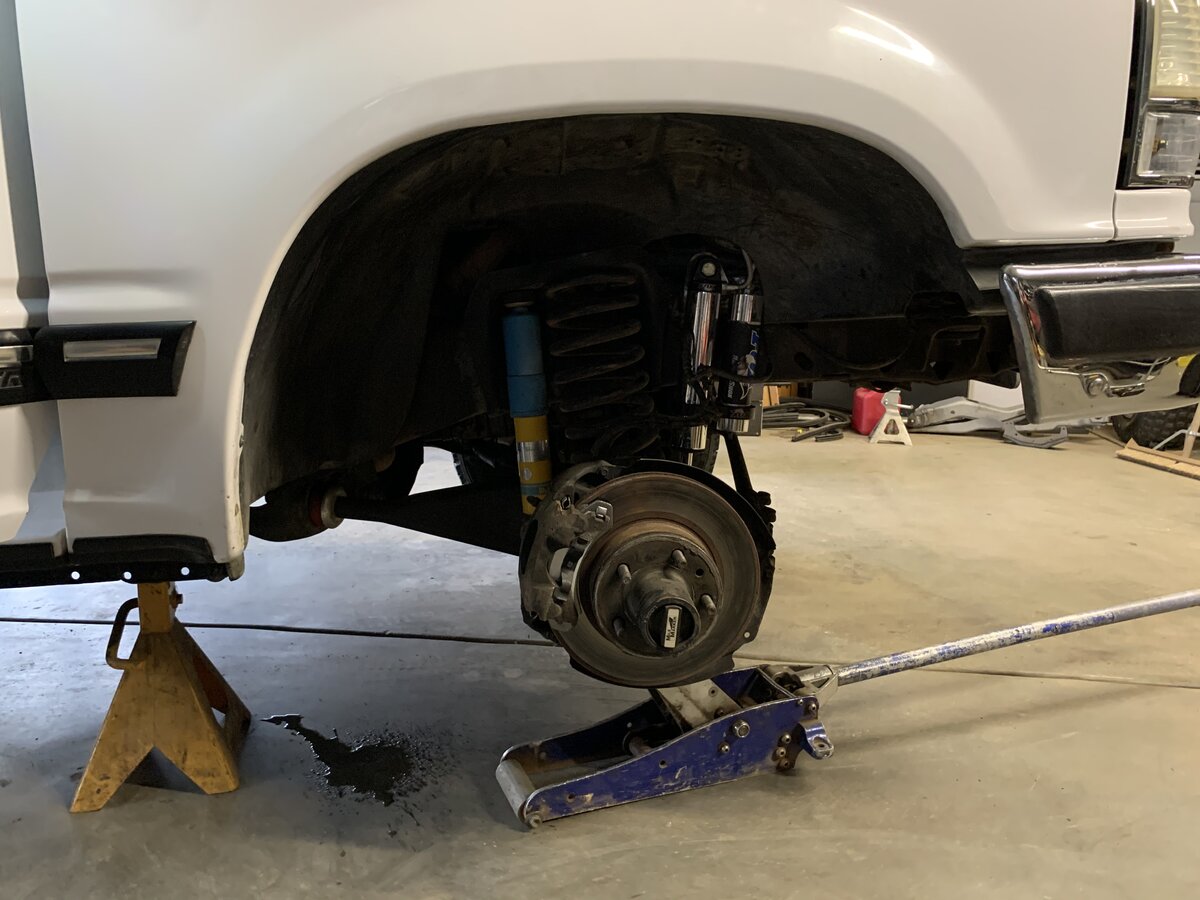

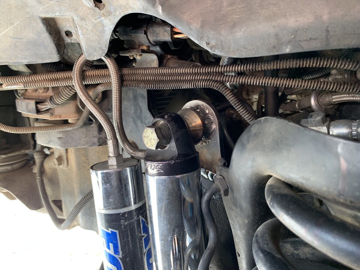

Couple new updates. I’ve been sitting on a pair of 2.0x6.5 Fox reservoir shocks. The intention was to put them in factory location, but they ended up being too long. I switched them over to the front by trimming and using the factory sway bar locations with weld washers added for strength. The upper mount is simply a tab with a shock boss welded to it, that is the welded to the top outer corner of the frame. The only hang up was that the passenger side frame rail is slightly narrower, so I needed to add a .75” spacer to the back of the upper tab to push it out a bit. Super simple, & quick, and the additional dampening is definitely noticeable.
And the update I’m really excited about is these 33x10.50R15’s. My truck is only lifted a couple inches, so fender liner trimming was 100% necessary. Zero rub going forward, bad rub in reverse. I’m sure when I get my toe set by an alignment shop it will be better. Stoked on the new look, and these thing ride WAY better than my clapped out China AT’s, & they aren’t even balanced yet!

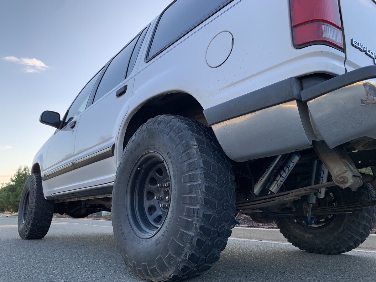

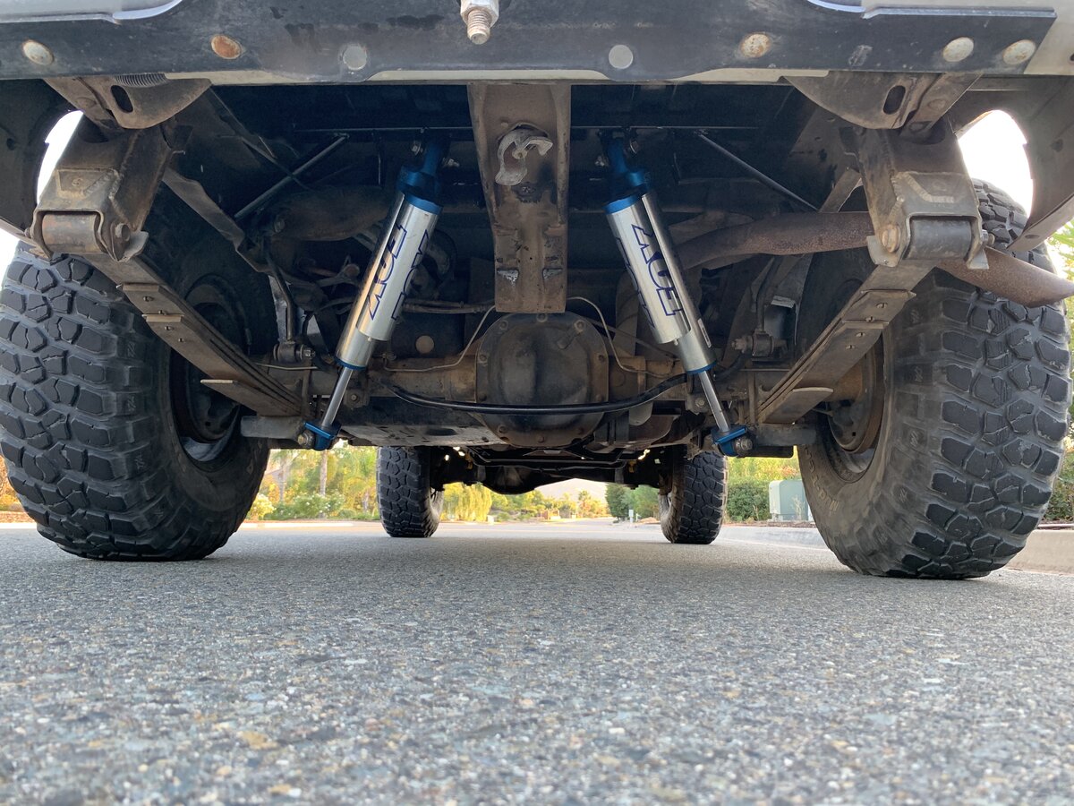

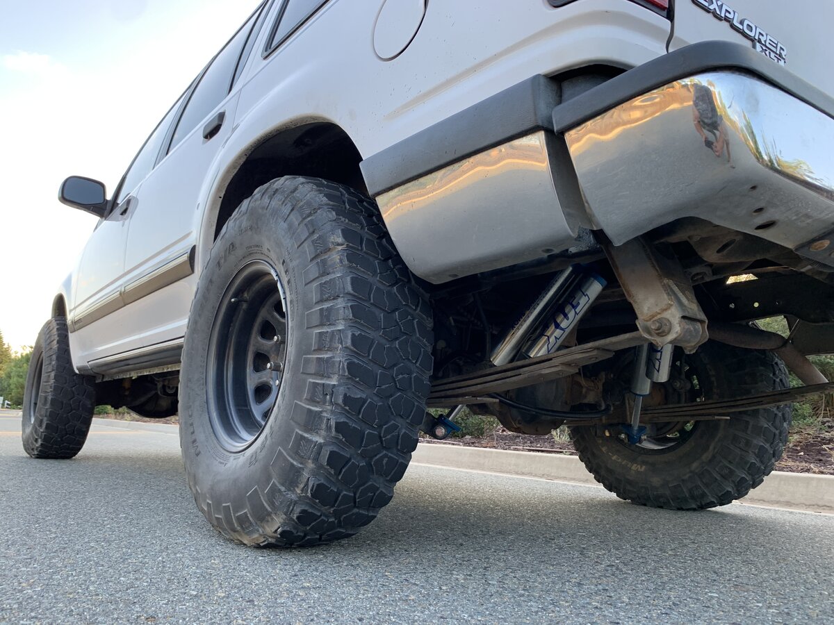

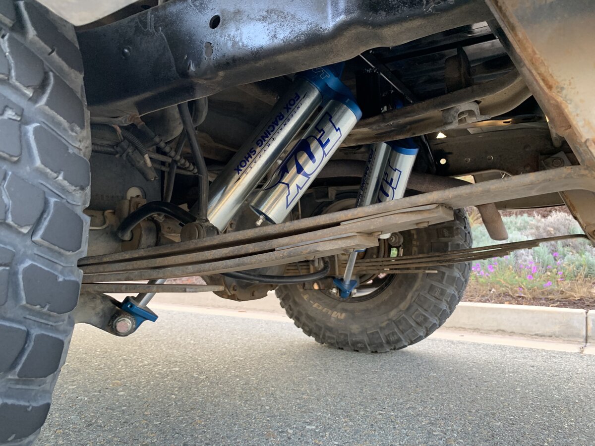

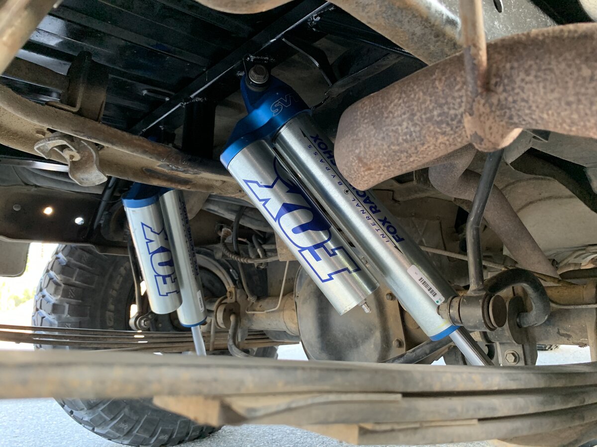

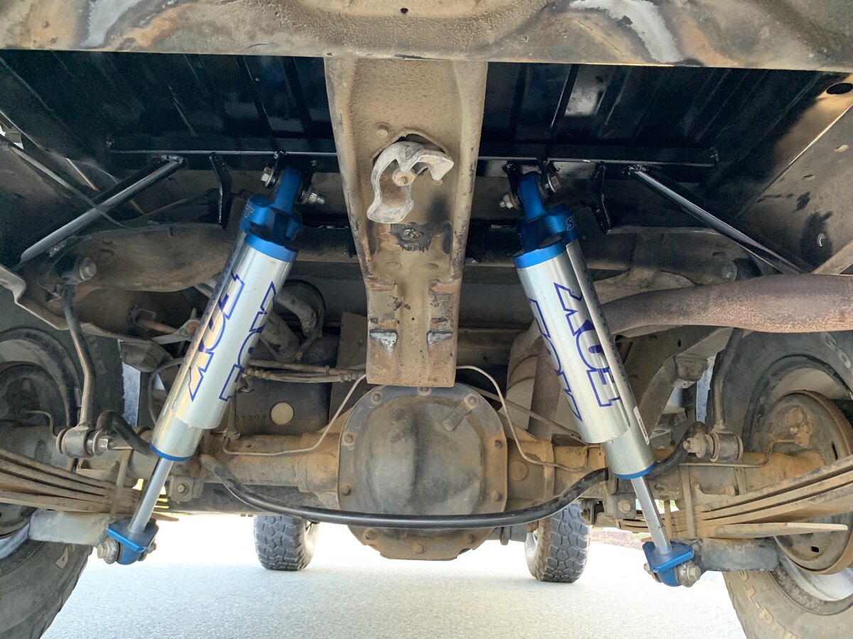

Had a chance to tackle the rear shock install. These are oem rear shocks from a 1st generation Raptor. They are internal bypass shocks (position sensitive valving). Because of this, my goal was to have the shocks sitting at a similar ride height as a Raptor. Measurements are 2.5x11.5 with 7/8 shafts, and are closer in size to a typical 2.5x10 shock. I had a friend add shrader valves so that I could cycle the shocks for install. I was able to notch out the factory shock crossmember, add my own crossmember, and do some creative tie ins and gussets. I’m really happy with how the truck is handling so far. The shocks are nice & soft on the street, and the valving really ramps up in the bump zone keeping the truck much more predictable in big bumps (& jumps).
Very nice. I had, four if I remember right, rear shock mounts fail. The OEM cracked all the way across, then when I was paying someone to do the work, they welded a 2x2 piece of 3/16" wall square tube across where the OEM cross member was and welded shock tabs onto that. That bowed. I made a shock mount out of 1.25 OD DOM, which cracked. I gusseted the heck out of it and it cracked again. This last time I built a new one out of 1/4" wall DOM with gussets that boxed in the frame at the ends. I think the issue was that the other cross members allowed the frame to twist and it would wiggle a crack into it. This one doesn't let the frame twist so it should hold up better. Redid the axle mounts as well. The last time the shock mount failed was right after I had the custom leaf springs built. I ended up with 11" long Rancho 9000's for the adjustability for different loads so I could tighten them up when remote camping. I accidently jumped it when I was going too fast down a road I was not familiar with and it handled it well.
I have built and broke a few myself! This time I decided to not completely remove the crossmember & just notch it out & reinforce it. You can kind of see that the frame kickers off the frame are also welded to the crossmember. What you can’t see in this pic is a 4x4 plate & a piece of 2” chromoly tube tieing into my crossmember above the spare carrier. Hopefully it holds up!
Night run this Friday to Plaster City?
Spare tire mount and cross members went away on mine many years ago. That looks strong. I like how you managed to retain the rear sway bar. I was messing with the idea of putting mine back but the space for the sway bar is taken up by my axle shock mounts. Since you retained the spring under and OEM lower shock mounts the sway bar fits. I might do more rocks than you so I moved everything up above or even with the axle.
I will have to see if my rear axle is back together by Friday. Its not looking good since the ring gear bolts are lost in the mail and I ordered a new set. If they come in by Wednesday, I could get it back together in time for a Friday night shake down run. I always allow the full 24 hours for thread locker and RTF to cure before I fill the diff with fluid.
Thanks, so far I am really happy with it, & keeping the sway bar was something I really wanted to make happen. I’m not a huge fan of the stock lower shock mount myself, but it actually helped with how long these shocks are. We are almost ready for a San Diego Explorer run, I definitely have some buddies that can join.
