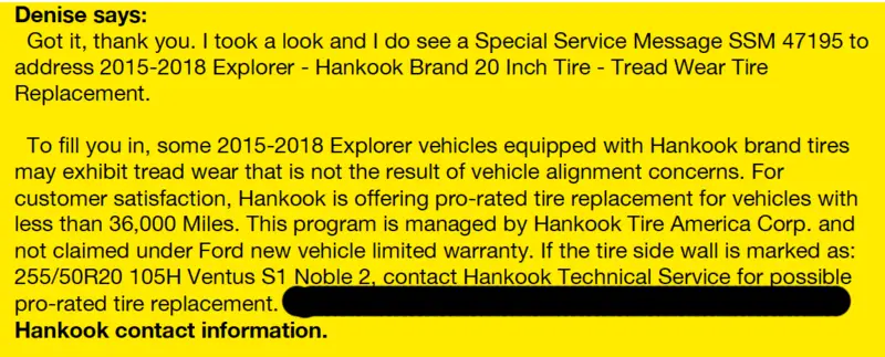

Tell them you want to file a consumer complaint. They'll need your info, VIN and your mileage. Then you can tell them how your Hankook tires which came OEM on your Explorer are wearing prematurely even with proper care. They told me, "...I do see a Special Service Message SSM 47195 to address 2015-2018 Explorer - Hankook Brand 20 Inch Tire - Tread Wear Tire Replacement. To fill you in, some 2015-2018 Explorer vehicles equipped with Hankook brand tires may exhibit tread wear that is not the result of vehicle alignment concerns. For customer satisfaction, Hankook is offering pro-rated tire replacement for vehicles with less than 36,000 Miles. This program is managed by Hankook Tire America Corp. and not claimed under Ford new vehicle limited warranty.
In this case, I would suggest speaking to the Service Manager and mentioning this program."
I then asked for a case number. You can take that case number to the service advisor at your local helpful Ford dealership. In my case, I had already had them replaced at Discount Tire, and they knew exactly what to do, didn't even flinch. Afterwards, for good measure, I sent my local dealership the case number just for records etc.

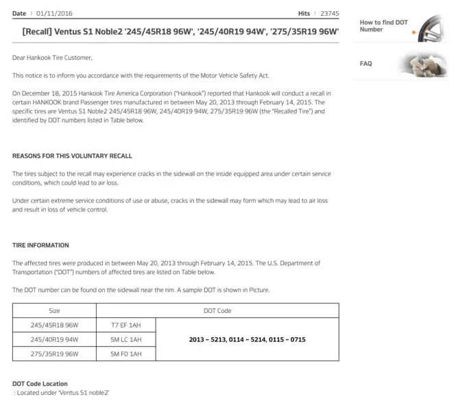

KAM,327, mine were worn evenly too. I remember seeing a recall on Hankook's website for .. scratch that, they've removed it. It was a service bulletin about a few of their tires and something to do with sidewalls falling apart. Geez, what a company. HA! They've recently posted a CYA document on their website! OMG! They are trying to cover their arses!!! (They mislabeled it January 2009.)

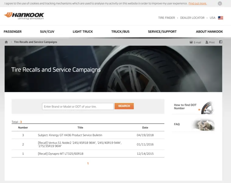

I looked on hankooks website and there were only 3 recalls, and the tire for the explorer wasn't listed . Where is this document?

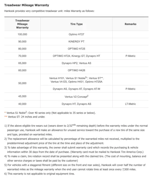

that's because they recently removed it. Here is what I had screen grabbed prior. It was for 18-19 inch tires, but ours were 20s and they covered them.
Those are just pages I grabbed for support.

This is what the rep at Ford mentioned...

"Special Service Message SSM 47195 to address 2015-2018 Explorer - Hankook Brand 20 Inch Tire - Tread Wear Tire Replacement."
I spoke to Ford to start, "...some 2015-2018 Explorer vehicles equipped with Hankook brand tires may exhibit tread wear that is not the result of vehicle alignment concerns. For customer satisfaction, Hankook is offering pro-rated tire replacement for vehicles with less than 36,000 Miles. This program is managed by Hankook Tire America Corp. and not claimed under Ford new vehicle limited warranty. If the tire side wall is marked as: 255/50R20 105H Ventus S1 Noble 2, contact Hankook Technical Service for possible pro-rated tire replacement..." You can tell Discount Tire and they'll know what to do, or file a consumer complaint with Ford so you can get a case number and take it to your local Ford Dealership service advisor so they can complete the process of getting your new tires and getting your family vehicle off of those dangerous tires.
