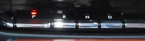

I've not had any problems fuelling the Explorer...but then, I put the gear shift dial in park before shut down.
