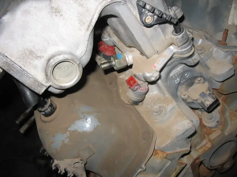

In this photo you can see the 96 engine-at least this one, has a fuwel pressure regulator.
Here is the return line
