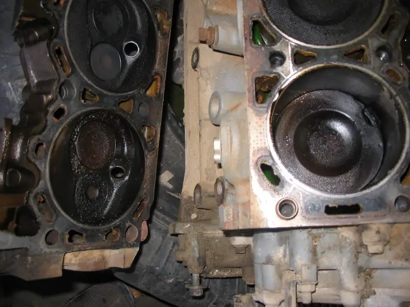

CARNAGE!!!
Look a little closer
that is #1
Here is #4
Looks to me like a plug electrode hit here--
Oh well, it is on the way to the junk yard now.

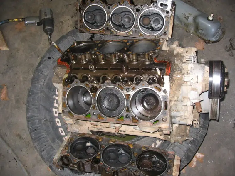

Here is the new, 3rd engine. 96 long block with 92 upper and electrics
so what caused that to happen?
if all 3 of those injectors were dead why did only #1 get damaged? if there was zero gas then theres no detonation. so if none of them are firing at all no damage should be incurred right?
so why would the #1 plug get all messed up like that and how did that piston get such a big chunk taken out of it?
im curious how this all went down. when you started the trip with bhe truck was it running on all 6 cyls? and then 3 injectors failed, then the #1 plug fails and destroys a piston and then your oil blows out bc of the insane blow by and the engine is ruined.
is that how it went down?
I am also curious as to the sequence of this. Things rarely happen all on their own. There is almost always an "event cascade". This minor thing happened, which effected this, which effected this, which caused this to fail, which brought down the plane.....
