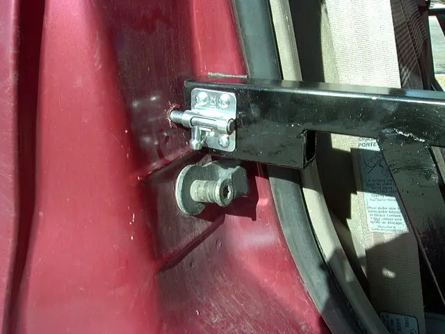

i dont agree with the latch being oriented with the locking slot upward... gravity and vibration will cuase it to fall back down... that lock may prove to be ok, if it was flipped 180*

I originally was going to mount it that way, but it would have been impossible to unlatch it. If you look at the picture, you can see if it were flipped upside down from the way it is, the little handle would have been really hard to grab. It would have almost been contacting the hinge for the rear door. Beleive me, I really wanted to mount it that way, but it just turned out easier to mount it the way it is now. Like I said in an earilier post, if I find it unlatching itself, I will just put a string or bungee around the latch and attach it to the tube door to hold it closed. Right now, I haven't had any problem with the door coming unlatched. The padding between the door and the body of the truck keep it pretty secure.

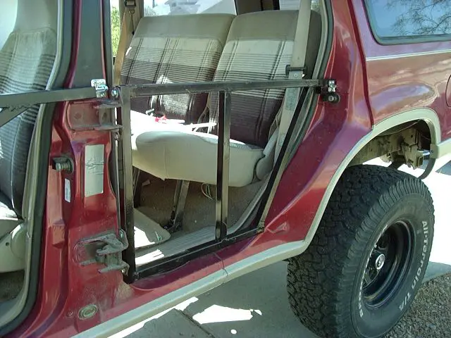

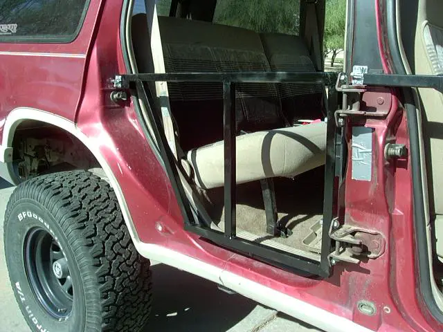

Got the rear doors built today. I will post pictures once I get them mounted.
I'm just waiting for the paint to dry.
Don't worry, the barrel latches this time are going to be attached to the door, not the body of the truck.
Will post pics of this too.
Damn, my welds just get better and better the more I weld. Its amazing how that happens.
-=Edit=-
Here are the pictures:
