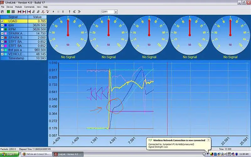

I take it that you are tuned already?
I never got a CEL, from the intake.
what other data do you want to see?
Spark timing
air fuel ratio
throttle position
speed
is there a way to graph all of them together?
do a 0-45 mph pull if you could--
I can do that (as soon as I get access to the laptop again)
I thought you were doing that yesterday-:confused: :confused:
when you disappeared-I said to myself "yep, he crashed his truck while looking at the screen---"
JK
Now, go slap your brother into submission and grab the laptop--:D
what software do you use and are you connected to the obdII port

lol, I had to go to bed. I didn't get all of those things recorded together, so I can't put them on the same graph, I'll have to do it again. Besides I was thinking that I need to do it with the stock program, and one of James programs to see if there is any difference.
Ok, since my mom has the laptop:( (could be hours before she gives it up) I"m just going to do it the slow way and record to the x-cal, and then upload to my pc. But it wants to know my ECM type, does anyone know what that is?

stock tune
will post with street tune in about 15 minutes
