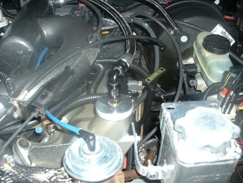

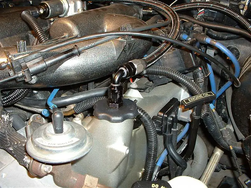

Do you have a simple vacuum gauge? If so, I suggest removing the catch can filter and connecting the vacuum gauge in its place. Then check for vacuum with the engine cranking/running. Without the PCV check valve I suspect you're pulling air from the atmosphere thru the catch can filter which flows directly to the main intake downstream of the MAF sensor.
