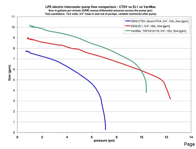

Guess ill throw this out here for discussion. .being the Bosch pump is not a direct drive,i wonder at what voltage does it take to over come the resistance of the water and weight of the blades??? Like most fans wont start spinning till say 6 or 7 volts is applied, this was pointed out in that article. .would or does this happen with the Bosch pumps..a direct drive pump i would think would take less voltage to get it spinning. .also the most restrictions the Bosch pump has as far as water flow,the slower it spins.lower the voltage with high restrictions and it might not spin at all..
Thoughts or anyone wanna test this??

Water is basically incompressible. If there are no air pockets between the pump and the intercooler as soon as there is flow at the pump there will be flow at the cooler. However, the temperature of the coolant in the intercooler will not drop until the volume of the coolant in the heat exchanger reaches the intercooler. Below is a graph of flow vs pressure.
I was concerned about how the flow dropped to nothing at 7 psi so I inserted a pressure gauge at the output of the pump. As I recall the measured pressure was about 5 psi and it occurred within a few seconds of activating the pump.

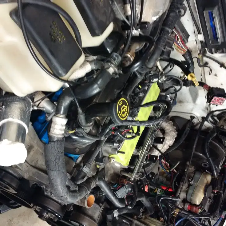

I'm sure this is the result of detonation, but the question is.....What do I do with the motor once its out? Just replace head gaskets and go?
Here's the all to familiar site:

Maybe Tim will post the track slip. He did pretty good (helmet worthy), and I ran a 14.7 at 90mph. Not bad for pulling off the gas.

Dono, I am so sorry this is happening to you. It just isn't fair.
Glad you are OK, coolant leaks at high speeds can do horrible things to traction. A coworker of mine had a hose blowout on a road course and sent him spinning. He was fortunate to regain control with out an accident.
Tim mentioned a turbo hose blowing off before you guys raced, was that a boost hose? What boost were you running? Please let us know what you find when you get the motor out.
Damn, a 14.7 while lifting? That shows the potential this truck has.
Did you spin off the line like Tim or did you have traction off the line?
