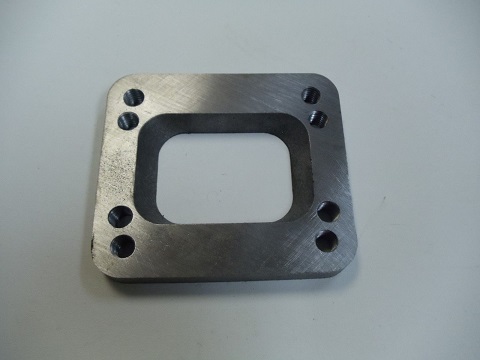

Look what I found.
The only other adapters I had seen previously were about 3" thick.
This adapter is only 1/2" thick. This will save me a trip to the exhaust shop.

I didn't use the adapter. I decided that due to rust (Yes, I tried to remove some bolts that are on the current threaded flange and broke one) that I am best to go with a T3 flange that bolts the turbo on with nuts/bolts so on the next removal I can just bust the bolts if I need to.
And, yes, it was a trip to the exhaust shop.

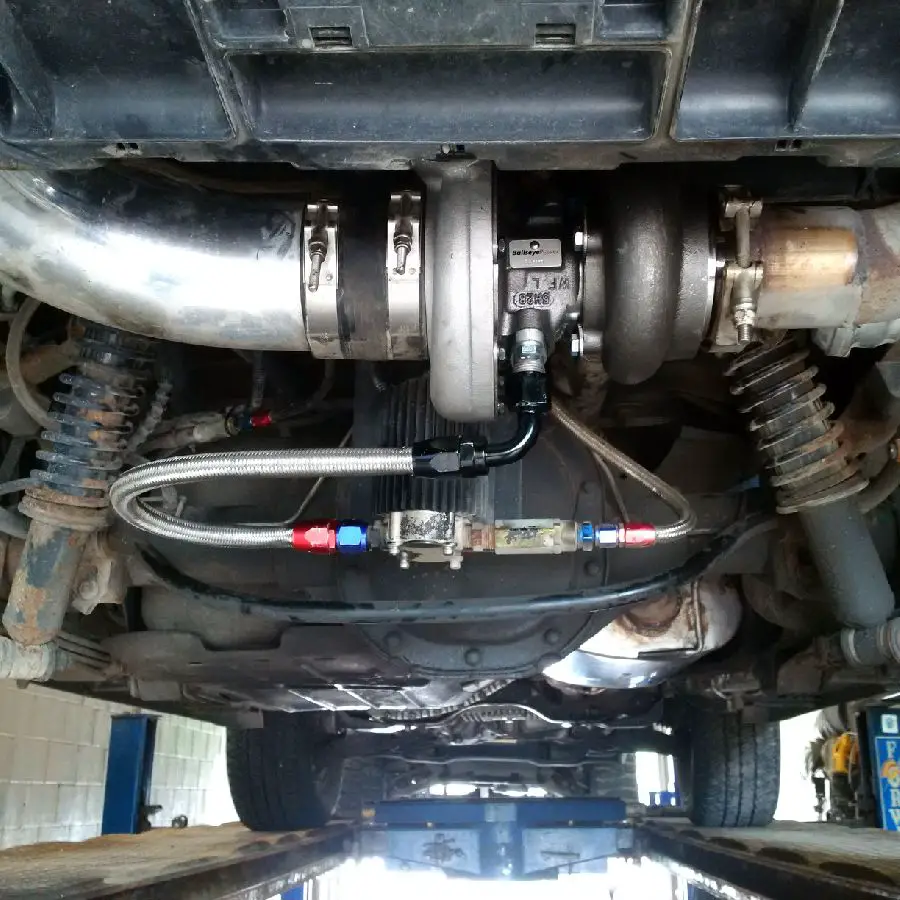

First impressions? The turbo is singing all the time. There is no hiding the turbo sound. lol. At about 30mph, the rear tires break loose. The truck is way louder at wot now, and when I let off the gas in a hurry, the blow off valve makes a super loud pop, and not the burble it used to make. On the highway, there is no boost unless I ease on the gas with the intent of solid acceleration which is perfect.
I've had a few minor issues to deal with, including a blown header gasket (thankfully the drivers side), and a fouled spark plug. I was 2 heat ranges colder, but have switched to one heat range cooler now, hopefully there won't be any more fouling.
Then I had a bit of a scare as I developed another oil leak. It did turn out to be the oil dipstick tube needing to be re-seated in to the block with ultrablack (between moving it around to replace the header gasket and spark plugs the original seal obviously broke). It's amazing how much oil leaks out of that dipstick hole if there isn't any sealant there.
I'd like to paint the exhaust exiting the turbo also, possibly powder coat it, but it all seems to come down to time and energy.

Sweet :D Glad it's working out well for you:burnout:
