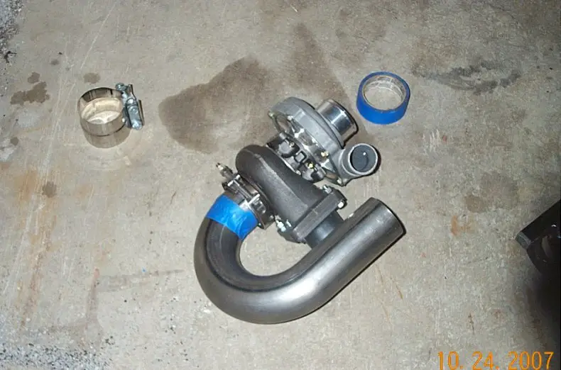

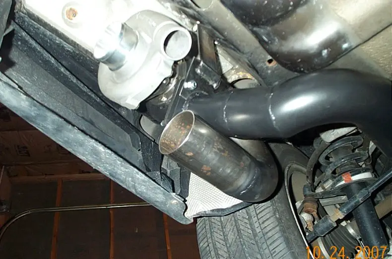

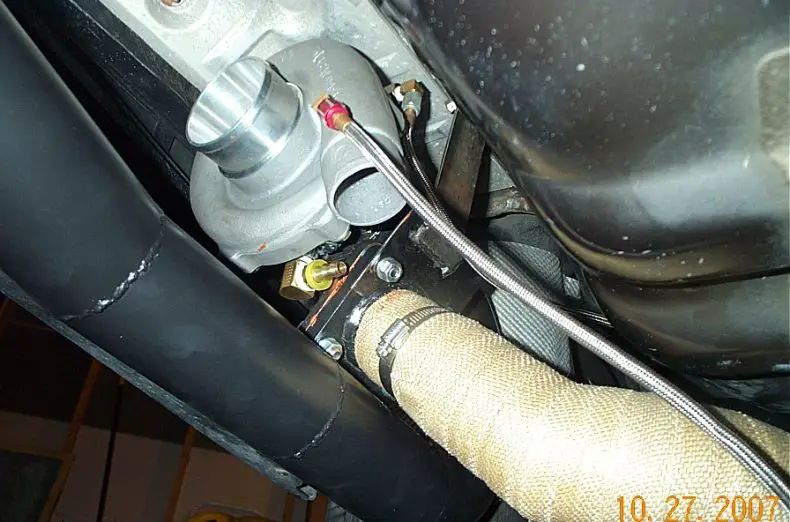

Obviously this is not an Explorer, but it sure is "Need For Speed". This is one of the projects I have been busy with lately.
Here are the specs on the mods: Custom Garrett T04E 60 Trim Turbo, FMIC, Tial 38mm WG, SCT Xcal2, Ford GT fuel pump, Cobra 39lb Injectors
I plan to boost it to 4 psi on the street and likely 6-7 for track days. It should make enough power to go 12's. I finally got it out of the garage and started it today. You cannot hear the turbo much because its just idling but the exhaust note itself does sound pretty good.
I just started tuning it so there are no power results yet. Those will come soon.
Here is a quick video of the build. Turbo LS Build Video

Pics should be fixed. Here are some more too.

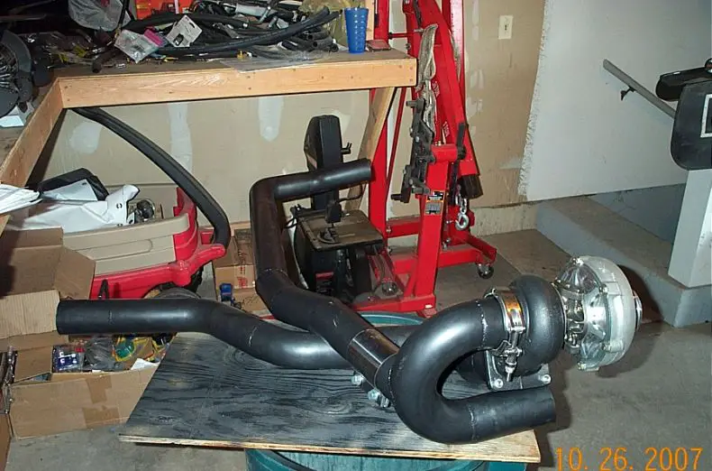

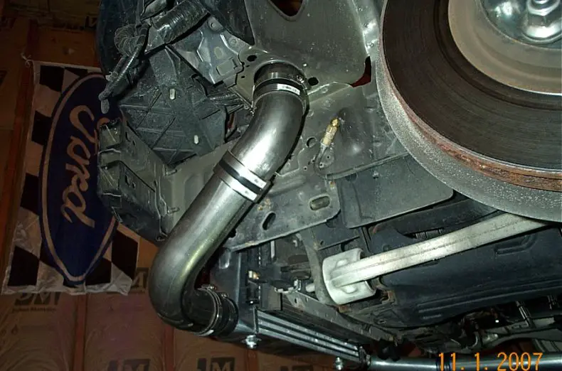

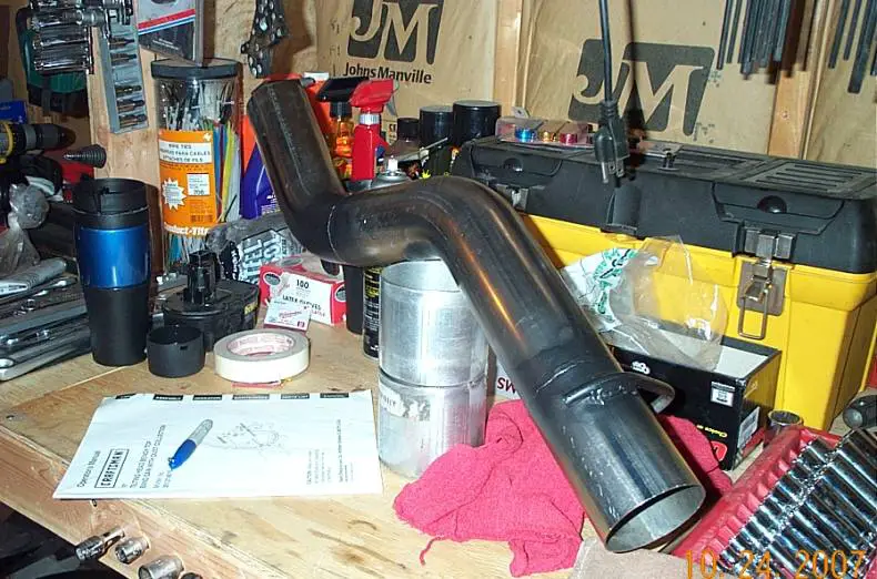

More Pics...

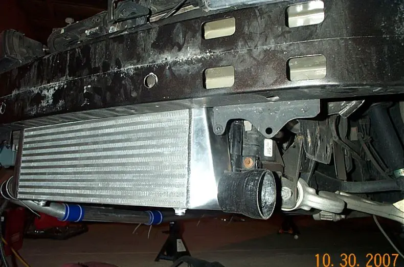

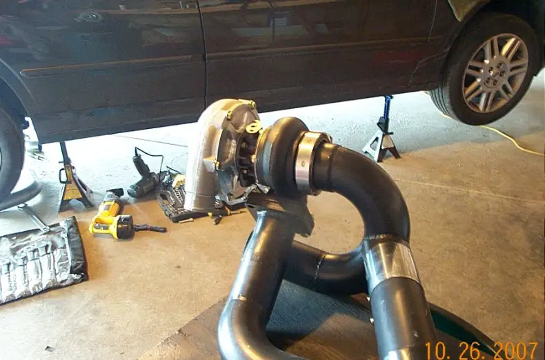

Nice work. very clean install. I like, and it sounds mean at an idle. (I can hear the turbo)
I also like the dual exhaust coming out of the turbo. I think you gave me an idea.

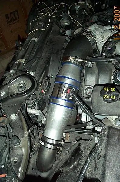

Robert - Is that 2" pipe on the cold side?
we're going to have to race teh sedan's eh?
Thanks.
Yes it is 2" aluminum tubing on the cold side. Once it hits the FMIC it steps up to 2.5". Then coming out of the FMIC it steps to 3" and then from 3" to 4" into the MAF sample tube. I should be able to use the stocker MAF in this larger sample tube and retain good drivability while also not maxxing the MAF with the turbo. If I do end up maxxing the MAF then I will move to a PMAS HPX meter (otherwise known as the SCT BA5000). Once I get to really doing some WOT pulls then I will see what I am dealing with.

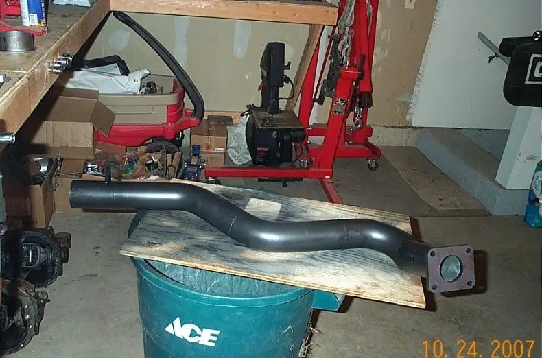

a MIG welder would mean cleaner beads, remote setup isnt bad though, getting it tucked in there is the key
No, more practice with my welder would mean cleaner beads. ;) I had not used my welder for anything more than laying a small bead here or there. It took some getting used to. The beads were laying down pretty damn nice for a MIG welder once I got the hang of it. The pictures do not do allot of the welds justice due to the way the light reflects off of them.
I agree, if you want to see every mistake and flaw, post the pics on the net. I usually take pics and they look way different in person. I post them on the net and realize it looks like crap. (Not saying yours look like crap)
