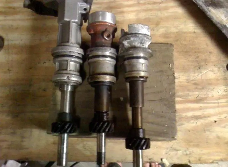

alright. so the 408 powered mounty project begins today. first step was to identify the path for making the CMP sensor. i have a 351w dizzy, an explorer CMP and a 3.8L mustang CMP for comparison. as you can see, there are some differences.

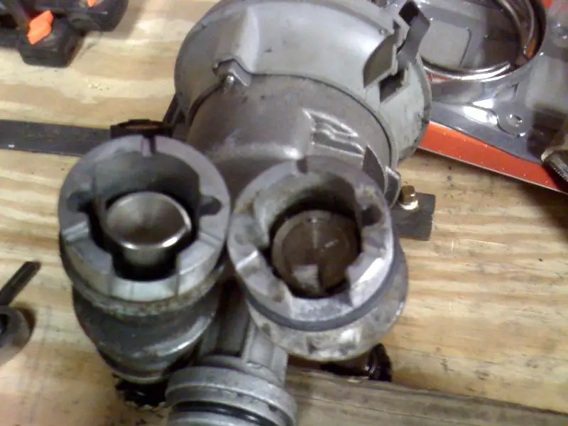

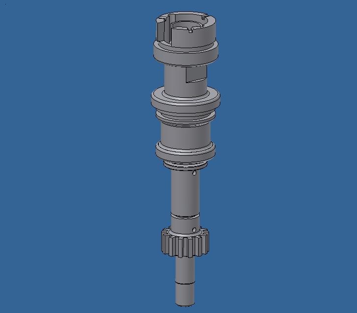

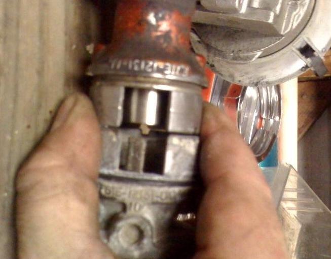

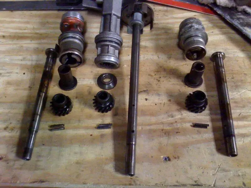

i have been doing alot of reading up on this. you can't use the stock explorer body because the hole in the 351w block is bigger than the 302, but not enough to "bush" it. the v6 version has a small enough diameter to bush it to fit, but the shaft lacks the extra length at the hex end to have a safe (in my opinion) engagement depth with the oil pump drive shaft. it also has a smaller flag, which i don't know if it will be an issue or not. so, there are 2 choices to make this thing work properly. first, graft the 351w dizzy shaft bottom to the upper part of the explorer shaft and place the new shaft into the v6 body with a special made bushing to adapt it to the 351w hole size. that doesn't really sound like a great idea to me. next is make the damn thing myself. so, thats what i plan to do. my lathe skills suck, so i am going to enlist a friend. i am only going to make the body and the shaft. i will reuse the collar, steel gear and the sensor. this is what its gonna look like...
lets try this again...
FYI...i just found out the smaller flag is for the 2 wire sensors used on the later vehicles. not sure on the cutoff. autozone lists the 3-wire on 97, 98 and 99. it lists the 2 wire for 99-01. so i can't say if 99 is a mid-year change or if its late build 98's or a mistake.
my friend cant make the parts, so i had them quoted. just the shaft and the body...$700. kinda figured it would cost that much:( i am now looking at 2 other options. v6 CMP body with a machined sleeve with an o-ring groove pressed on to fit in the block hole. the options would be to either get a shaft made up ($250) or cut and splice the explorer cmp top half and the 351w dizzy bottom half together. the easiest thing would be to use the factory collar to provide the joint between the 2 halves. since all the torsional load is only in the bottom half (between the gear and the hex), it only needs to be strong in bending moment so the bearing in the body is effective. press fitting the 2 halves into the collar and pinning them would likely be enough. but opening up a pair of 3/8" holes in the collar at the joint and plug welding all 3 together would be sure fire. just gotta make sure i never need it to come apart again and make sure i don't overheat the parts and risk warping the shaft. if i can get a decent price for the sleeve and shaft, would anyone be interested in buying in with me?
