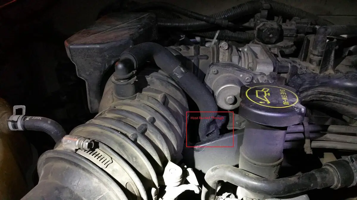

I have two problems I was hoping to get some help with... I'm a computer engineer and this isn't my area of expertise so please excuse the poor descriptions of the problems.
1) There is a hose that is burned through that connects to the air intake manifold. I'm not sure what it does... how can I find a replacement part? What is it called and what are the consequences of that? The engine has been idling rough

That first pic of big line is also a vac line, and a dealer only part. Best bet is to go to a junk yard to get one.

They will definately make the engine run rough.
