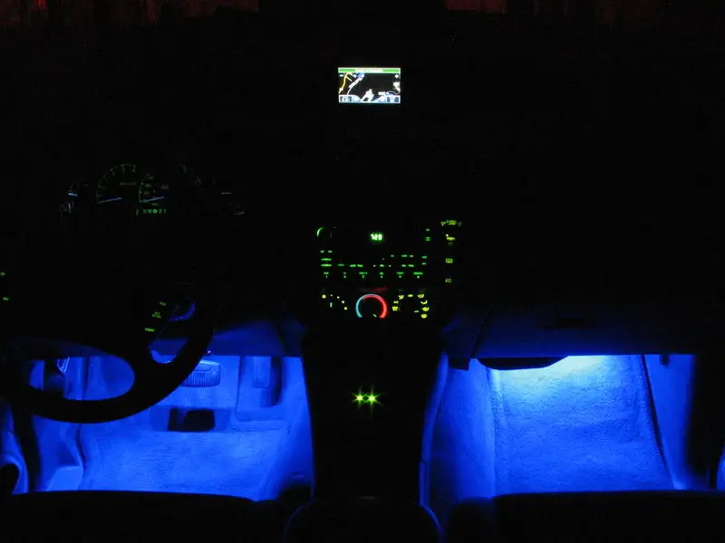

I wanted to do this for a long time, and I finally got some time last week. Very cheap only cost about $8.00 used 5 15,000 MCD 5mm Blue LEDs on each side, mounted on project boards that can be found at Radio Shack. I Highly recommend this, it gets a lot of attention and is a nice accent to any vehicle. This is practice for my chassis under glow project Im doing this spring. What do you guys think?

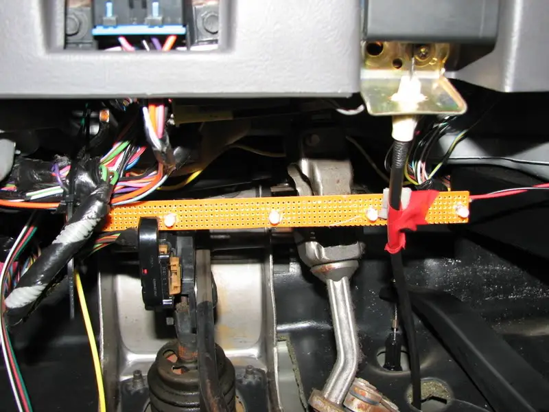

The LEDs were originally 60 degree focus, but they only made a spotlight, so I ground off the tips to make them disperse the light evenly. I mounted the passenger side with some double sided tape, and on the drivers side I used a zip tie and electrical tape (only temporary). As for the board length I bought the biggest one Radio Shack had and then cut them with the Dremel.
Drivers Side
And no the board is not resting on the brake light switch wiring harness
Pax Side
