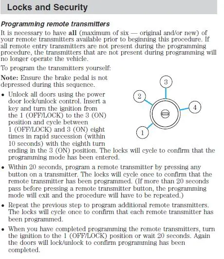

Does anyone know a way to have a 2001 Explorer unlearn a remote key fob? I currently have a remove that works on my 2001 EB and on my 2001 ST. This is a less than ideal situation. If all else fails I suppose I could just replace the key fob with 2 new ones for around $10.
What if I put either vehicle into programming mode and don't program the offending fob?
