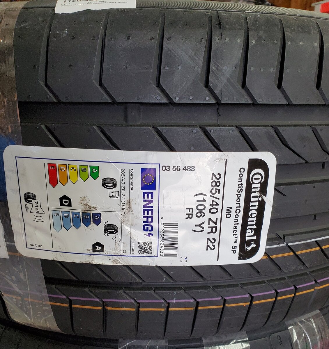

I did exactly what the OP is wanting to do. I found a set of 22x9 factory wheels that I liked and had the hub bore opened up from 63.4 mm to 70.5 mm and I used a 285/40/22 tire. Tire rack lists the stock 255/55/20's as a 31" tall tire and so is the 285/40/22 some brands come in at a 30.98" but it's so close I wouldn't worry.
I also lowered it with the steeda springs, and added a set of 1.25" bora wheel spacers and have no clearance issues what so ever. The wheels are from a 13-14 edge sport and have a 39 mm offset.
That tire size will also be good. Do you get any rubbing on tight turns?
Peter
Absolutely none, and as I said it's also lowered and I have wheel spacers too.
As you can see they have about a half inch of poke all around. Frankly the ST should have came with this setup from the factory.
