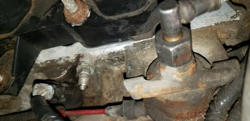

I replace the upper intake gasket on my 4.0. It had the rubber o ring style but the parts store said the paper style was an up grade. Well she's back together and has a leak. It's in a little notch that must be there to hold the old gasket in. I have looked online but can't find 5he correct ones. Please help
This sounds dumb but can I just fill the little notch with RTV. It's just a little notch in the middle of the runner the old.gasket must of had a tab that went in there
I cant tell you what to do, but I would not do that, Do it right, the way it is supposed to be, even if it requires removing the upper intake one more time. Silicone has to be compressed to be held in place, if you try to fill the void, it will eventually fall out and get sucked into the engine.
Is the notch you're talking about right above the Schrader valve? If so you could try a dab of JB Weld there to see if it stops the leak. But as BlackSport stated, the O-ring seals are the correct ones to use there. They are designed to compensate for the varied expansion rates of the plastic plenum and aluminum fuel rail.

The 95-96 intake plenums appear to indeed take the one piece gasket, and the 97-00 models
use the O-ring type. I suspect your 95 truck has a later model engine installed, or maybe a different
plenum. You can try taking an old gasket to the parts store and see if it matches up to a 97 or later
model year gasket. (The intake runner openings have different shapes and that's why it's leaking.)
Rock Auto (parts) has a lot of pictures and info; maybe you can confirm what model year gaskets
you need by searching there...
