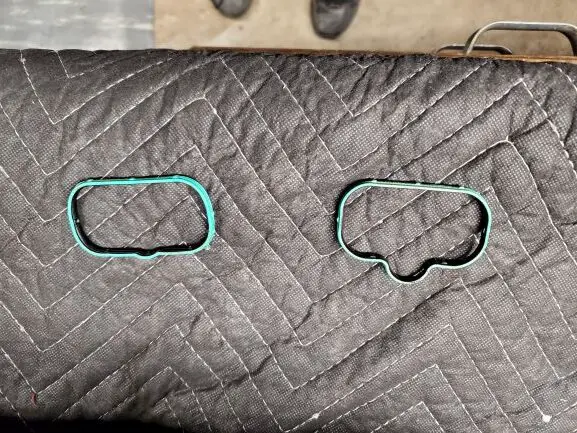

I need to replace the intake gasket on my 06 Explorer V8. I have the intake off and can see that there is some damage to the upper gasket for cylinder 6 but according to ford the upper gaskets are not serviced separate from the manifold assembly. Has anyone found a source for the upper gaskets? I think I will be trying liquid gasket before I spend $750 on a new manifold...

For the unfamiliar, these are the ones that go between the intake plenum and the CMCP's (see pic below, right side). At least on my '06 4.6L 3V, they are slightly different shape than the lower ones that go between CMCP and the head(see pic below left side). The upper one has a larger "bump" to accommodate the fuel injector. Hopefully the picture below will stick. Anyhow, even the Ford parts guy couldn't find it... Admittedly, I called during lunch hour so maybe the new guy was filling in or something.

Hey I’m have the same issue with finding the same gasket the one on the right in the picture it’s the one that goes in between the plenum and the CMCP for a 06 Ford explore 4.6 3v did u ever have any luck on finding one that was compatible

Hello, sorry for the long delay. Nope. Not available. I cleaned mine with WD-40 and put back in. No vacuum leaks so far...
