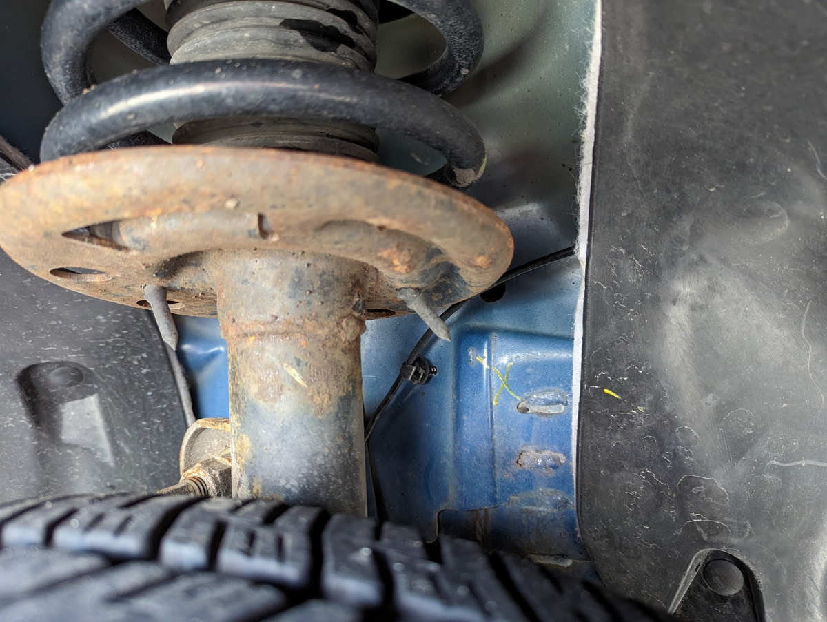

-4 Different Year tires w/ different tread depth 4-8mm
-Driver seat rocks back and forth
-Steering col bent (on rotation steering wheel height changes)
-Front Pass strut area has deformation (Groans on turns, sounds like bumper flex)
-Turbo inlets have radiator style hose w/ clamps
-Caulking around the timing cover
-Vibration at highways speeds on Front
-AC nonfunctional
Wondering what you all would do in this situation, I'm bringing it to the dealer today to bring up these concerns and hope I'm hitting all the ones that aren't nit-picky and just safety.

The accident report on CarFax did not say much. Strut mounts are common failure so I would check that first. Body mounts and control arm bushings are also common failure on the police cars that see heavy use. It was also exposed to north east weather so that will only accelerate deterioration.
The factory turbo piping is rubber/plastic. Its fine until you upgrade turbos.
RTV around the timing cover means someone probably already replaced the waterpump / timing gear. That is the most common failure point with the 3.5/3.7 engines.

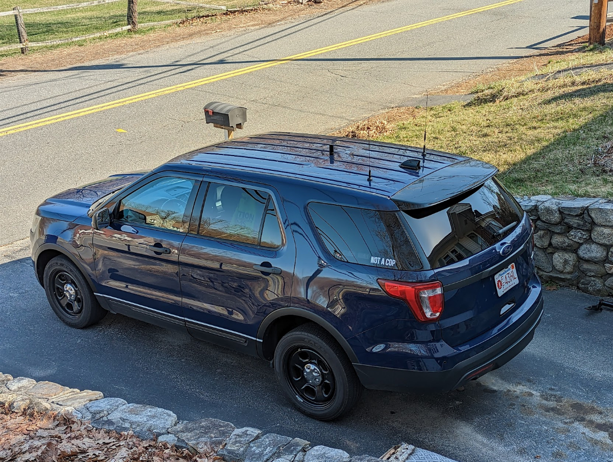

I fit in that category of a patrol vehicle being the right vehicle, and unfortunately my department (EMS) still has theirs in active duty for a while. But I drove that around for a while and loved the dynamics of it. The price matched with the ease of reoutfitting for EMS, just made sense. If they were upfront with the accident, I probably would have walked. Rust is actually minimal, like really minimal for a NY vehicle. Some pics of my car, and the work whip.

I'd check suspension parts like control arms, bushings and strut mounts. I just replaced mine and they're common failures. They've also occurred on my regular Explorer. The timing cover "caulking" could be from a gasket maker if the water pump was serviced, and given the mileage on the CarFax report, that seems to be the likely reason that "caulking" is there.
Checked under the lift a week ago, and these all seem in good condition. Thanks for the heads up, Ill be keeping an eye and take another look at them before Mt Philo Hillclimb this weekend. Hoping to change out PTU and oil before then too. Have a ford specialist that will be taking it in and changing out the rear toe links and looking at the whole thing for anything else out of whack.
