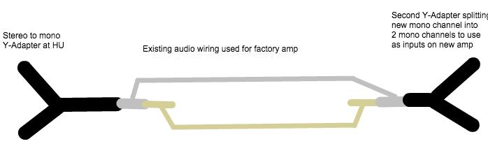

I'm upgrading the factory amp, and each speaker requires to wires (technically since audio is an AC signal, it's a hot and ground)(in RCAs its a shield and center core, the shield being ground). Maybe an image to describe what I'm wanting to try would help. I know TECHNICALLY it will work, but is it feasible for a quick install...
Since the amp only has a mono output, I don't really need the channels split. Why not just use the factory wires instead of running new ones.
I know it's not a problem to run RCAs, I've done it several times in other vehicles, but why do it if I don't have to? 2 Y-adapters is 5 bucks at my local WalMart, a 12 foot length of RCAs was almost 9. 4 bucks is negligible. But why pay more and do work if it isn't necessary?
I can cut the female end off of one of the Y-adapters and solder it to the existing wiring, and with the harness I'm getting free from crutchfield when I buy my HU I can just plug the Y-adapter on the HU side in.
Thanks again for your information on this. I may actually just try both running RCAs and modifying the factory wiring like I'm trying to describe (not very well, I don't think.. I have a hard time putting what's in my mind into words) just to see if there is a difference in audio quality... I can't think of any reason why it wouldn't work.

The wiring illustration you made is correct, as is your summary.
My take is just that it's easier, quicker, cheaper, and better to use RCA cables.
If you want to do the work and solder in the Y-adapter to the amp end, that might work, but keep in mind those thin, tiny factory wires are not going to be as good as a pair of thick, shielded wires in a dedicated stereo RCA cable.
Factory wiring isn't that great, but it doesn't need to be since the amp is low power and the distortion is VERY high - typically 10% or more. Most aftermarket head units output a signal with 0.1 to 1.0% distortion, and most amps are about the same. 1% distortion on a sub is fine, but 10% isn't good, both for the quality of the sound and the longevity of the subwoofer itself. One way of getting noise and distortion into a system is through the cables. Thin, unshielded cables can pick up noise from power, ground, speaker, and signal wires. Those factory cables will pick up noise that a properly shielded stereo RCA cable will not. That's why I think the RCA cable is the better route to go.
If you want to do it just to do it, it will work, but it will not be ideal compared to a stereo RCA cable.
If nothing else, I would call Crutchfield and ask if there is another amp-wire-to-RCA-plug adapter for the other end first, before resorting to cutting the factory wires and see if they will send it out for free, and/or search online to see if such an adapter exists.
