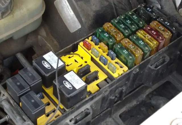

something like this?
just have to tap into the power and ground wires for the pump
You can power the pump to run AT THE FUEL PUMP RELAY under the hood with a simple jumper wire, from 12V+ to the signal wire out to the pump

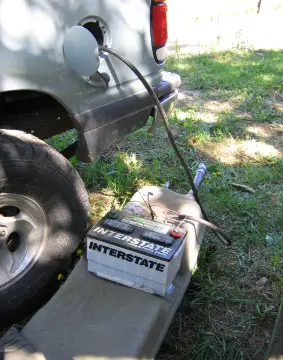

Worked like a Champ! Thanks!
I used and old Fuel line and connected the fuel filter to the gas tank.
Now I'll just pull up next to it and dump the rest in the lincoln.
I took this pic in case somebody else needs to do the same.:thumbsup:
