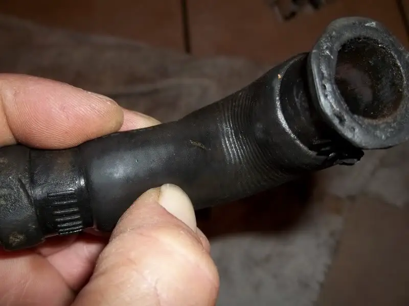

On occasion the little elbow hose will develop a small crack which will only spray under high pressure, leaving a tiny puddle on top of the timing cover area.
If you squeeze the hose you might be able to see the crack better
I hope you get lucky and this is the problem.
I have had that luck once before, it had a very tiny pinhole in it. But this time it appears to be coming from the gasket or something right above it.
