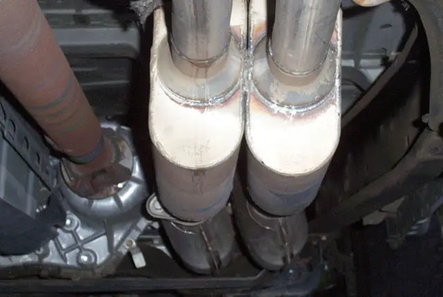

Hi,this is biff,I am looking into buying a 2001
Ford Explorer E.B. edition with a V8 engine.
I'm wondering if you have any pictures of the
exhaust system from the cat(s)to the tailpipe.
The reson I'm asking is that if there is any
room to fit two 40 series delta flowmaster
mufflers.I think any v8 explorer will do.Another
thing is,would that dual exhaust system sound
like a mustang gt,because I'v heard that sound
clip on the flowmaster home page under the
40 series muffler for a 1990 mustang lx.
Thanks.

yeah, it is dual in single out. if you give me your email i can send you some pics of my dual setup. I dont have the 5.0 but the SOHC has the same setup. I have a 50 series dual in dual out muffler.

I just happen to have a picture of my mufflers.
(dead links) They had to cut a part of the heat shield off and they only used 2 1/4" pipes. I wish i had got 2 1/2" pipes, oh well.

here... make it easy
