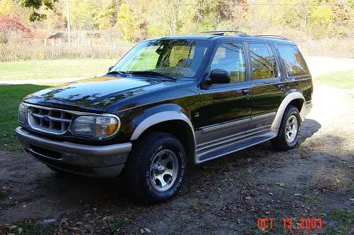

Well as a lot of you know, I have always hated the way the fender flairs look on my '97 Eddie Bauer. Well I toyed with a few ideas, and a few months ago took all the flairs/running boards off, and have been driving it like that. I liked the look, but the little holes drove me nuts. Well this weekend I finally got around to doing something about it, and painted all the trim. I think the results speak for themselves and am VERY happy! Ive got a little wetsanding/buffing to do, but it came out well!

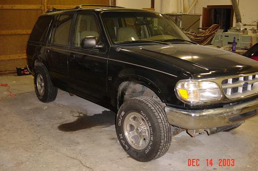

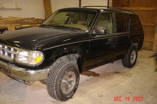

Here is a before shot, perfectly clean and stock truck:

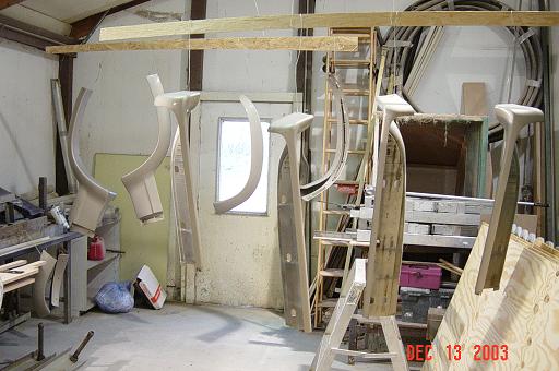

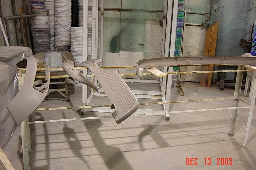

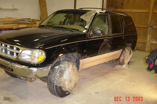

Prepped for paint:

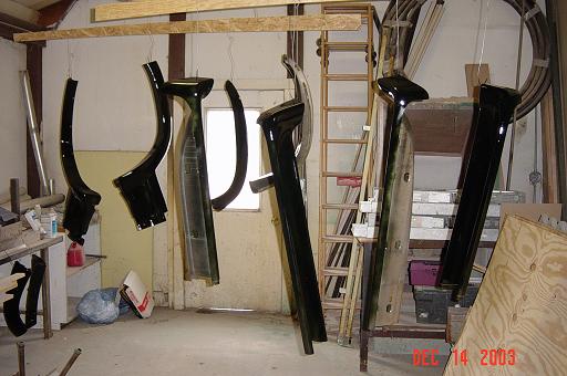

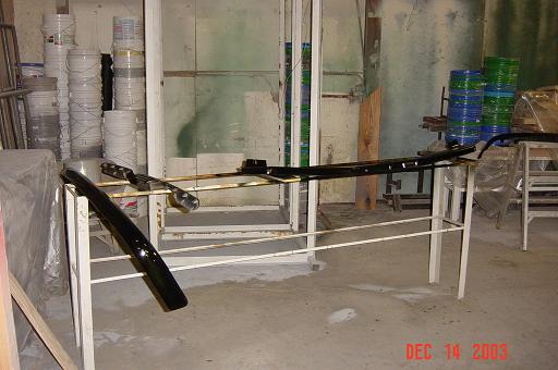

Various body trim parts:

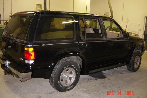

Truck painted:

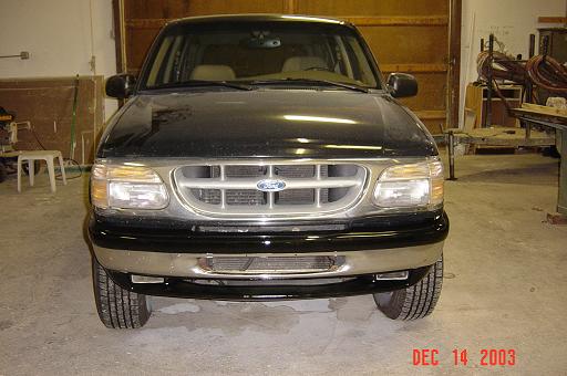

Heres the finished product, again, Im totally excited, the truck looks a million times better!
I plan on losing the pinstrip soon, and possibly do a mountineer front end with a 99+ explorer bumper...Should look pretty sweet! Let me know what you all think!
looks good... nice work... what did you use to paint the plastic and what prepwork did you do? plastic is very unforgiving to conventional paint techniques and paint composition as automotive paint doesnt need to flex like plastic... (i dont need t onkow, but others here will want to)
Ok... What painting method did you use? Did you degrain the bumper cover before or was it already smooth?

ummm... grille next?
xfactor, he said he was going to swap a mounty front onto it, meaning grill getting changed too

Basically all I did to prep the plastic was scruffed it down real good with 220 grit sandpaper, then cleaned it real good with a metal prep solvent, then painted it, 2 coats of black DuPont Chromabase, sprayed on with a real good HVLP gun, followed by 2 coats of DuPont chromaclear clear coat. I am hoping it will stick well, I have had good luck with this paint sticking in the past, so it should be all good!
how hard is it to get the top bumper pad off?
Easy...a coulple little push clip thingys...
Looks good! Was it hard to blend in the paint on the doors?
I have a little bit of wetsanding/buffing to do in order to get the doors to blend well, but the colors are the same, so it should be hardly noticable when its done...This paint is going to take forever to completly cure though, its like 20° out...

You gotta paint the chrome on the front bumper tho...

You mentioned it's going to take a long time to cure... how long? (Its going to be like 30-40 outside when I paint probably). Does the long cure time effect it in any negative way?
How come you didn't use a primer?
How did you prep the rear bumper? I was told if you take off the plastic parts on the rear bumper that you have to break clips inorder to do so - is that correct?
lastly... what is this metal prep solvent you speak of?
-patrick
He can buy a black front bumper.....I believe Ford has them in black... there are also some aftermarket ones out there too... If you look at mine the chrome one was replaced with a black one when I hit a deer... I had the whole truck repainted, the steps taken off, and the fenderflairs and Eddie Bauer tan primered and repainted black... the holes were covered with plastic divets and the flairs and rocker panels (all the way up to the trim) were then spray coated 5 times with black "rock guard" (a spray on herculiner stuff)... both the chrome front and back bumper can be replaced with a black one...it's probably less of a hassle and will probably run you less $$ to just replace it rather than have it prepped and powdercoated..

Oh oh oh...you should paint the silver part of your grill black too. It'll look sweet!!!
