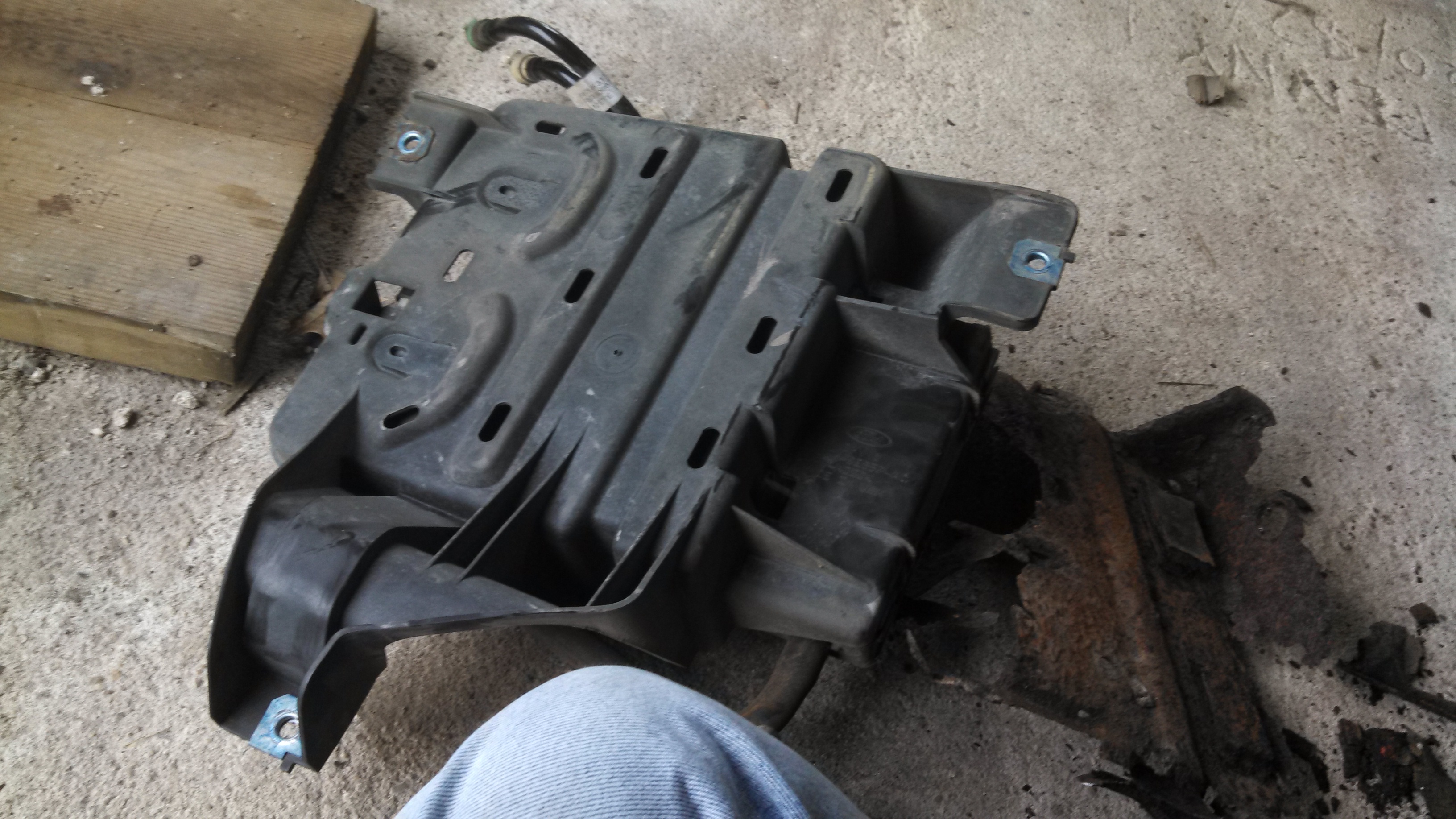

Yes direct swap, ive done this in my 97 sport and a few four doors , usually had to cut the old bolts with a grinder and cutting wheel , i also like to use an impact gun and kroil or pb blaster on the new one to try and save all the tabs and hardware, this is how my last one ended up

Yep, pile of rust and dust.
