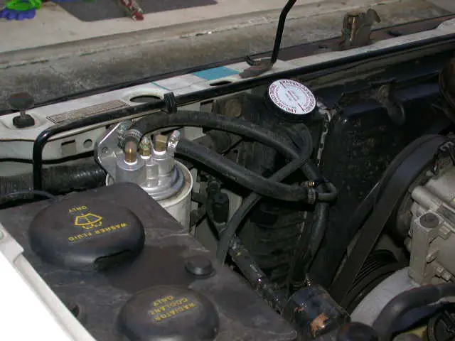

1st. when driving up a long grade at freeway speed, shift into D, not OD. This will lock up the torque converter at the 1:1 final drive ratio instead of the Overdrive ratio and cut a lot of heat from the tranny. This is better than just stomping on the gas pedal.

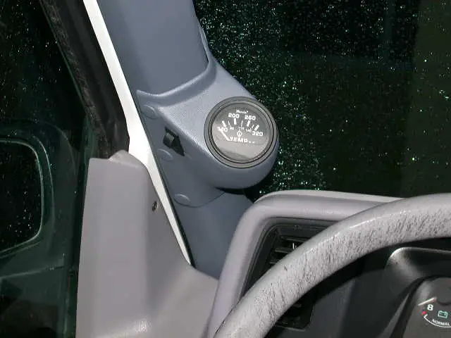

2nd. get a filter/temp guage so you know how much damage you're doing with heat.

think the filter is better than the cooler ? and what temp does your truck run ?
YOU need a transmission cooler.
I personally cannot believe Ford made Gen I and II trucks with light duty automatics without a cooler.
The factory cooler is barely adequate
A fully loaded Explorer should be able to pull hills at 3500 RPM annd much much higher, hell some of the climbs here in CO with the boat in tow and fully loaded with camping gear the 4.0L has no issue at 4300 RPM for 15 minutes in 1st & 2nd gear, as long as your cooling system is up to par.
tempature first, heat KILLS auto transmission fluid.
The fluid cools and lubricates, once its burnt it will not anymore.
the filter should come at the same time or after a gage and cooler.

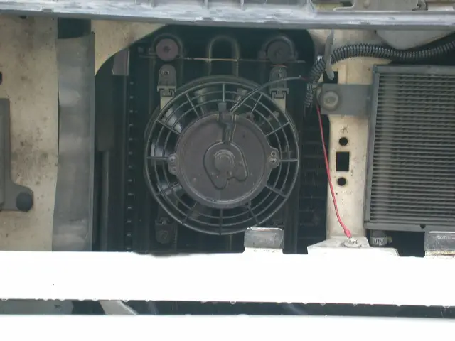

Oh, I have the factory auxillary cooler AND a second auxillary cooler. The switch on the temp guage turns on the fan.
I peak out at 220 towing the boat 2 miles up hill at slow speed from the boat ramp home.
There is a 20-30 degree difference driving over Snoqualmie pass between OD kicked down and driving in D with the torque converter locked up, . The last section of the pass is about a 6% grade for 5 miles
220 is about as high a peak as I would like to see too, I found those fin style coolers (perma cool, Hayden, etc) like the one you have pictured are not nearly as efficient as this stacked plate style:
http://www.bmracing.com/media/products/items/282_full.jpg
http://www.bmracing.com/index.php?id=products&sid=4&cat=20&subcat=28&pid=282
220 should not hurt the trans fluid, but if you are taking that temp at the cooler the pan temp may be alot higher...
You guys can imagine what a factory style cooler under heavy load, on an old transmission, hunting from 2-3 and locking/unlocking the torque converter will do........to me spending a little now to ensure I can monitor the temp and keep it around 210-220 max is the cheapest insurance I can buy on an automatic equipped vehicle......rebuilds cost upwards of $1200 and thats because I do all the removal/installation myself....
