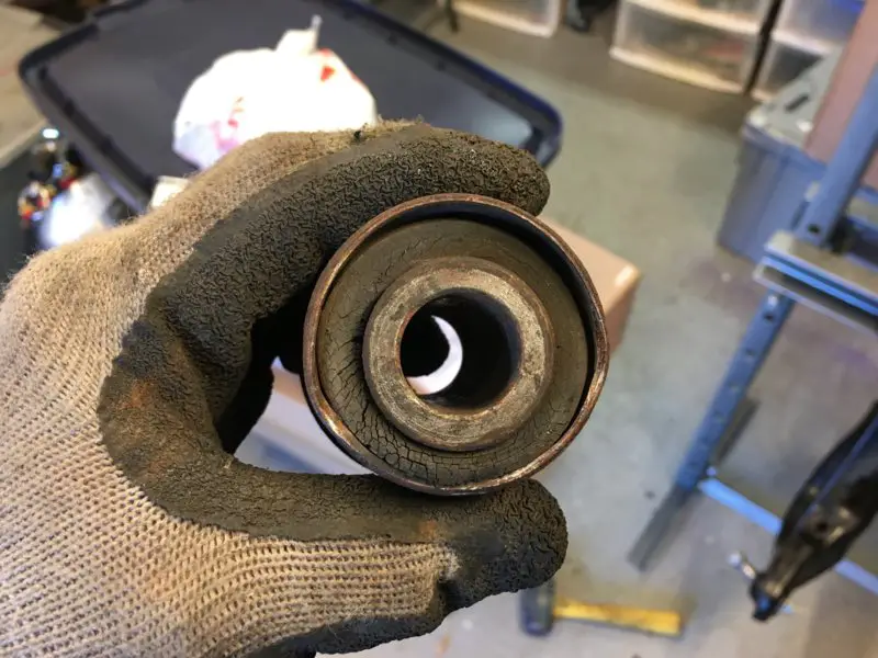

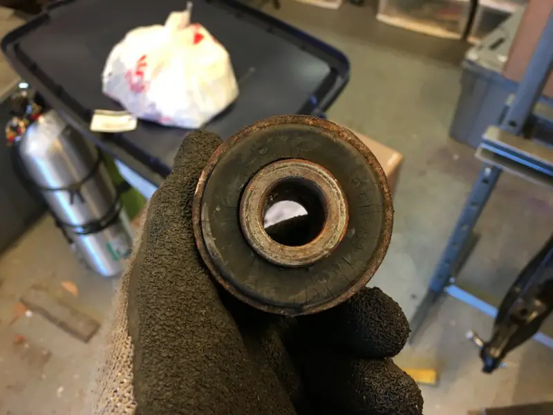

I know this is an old thread, but I thought I would add a bit to the knowledge base....
03 RWD Explorer LTD with 4L V6. I started noticing a shimmy in the passenger front prolly 40K miles ago. It wasn't constant - only started feeling it at about 55MPH, and it would rhythmically fade in and out. Tolerated it. Figured it was a ball joint, as all my past experience had associated such rhythmic-come-&-go shimmy with bad ball joints.
Finally decided to fix it and while I'm at it, do an entire front end rebuild. Replaced all ball joints, inner&outer tie rods, sway bar links, struts, upper control arm with bushings. Only thing *not* replaced was lower control arm bushings.
Got it aligned - shimmy still there. Rotated tires (twice); shimmy still there. Working on the Sherlock Holmes process of deduction ("when you have eliminated all other possibilities, whatever remains - no matter how improbable - must be the answer"), decided it *must* be the lower control arm bushings. Sure enough, the forward bushing looked like this:
The crushing on the side of the bushing was much less noticeable when it was still in the control arm, TBH....
