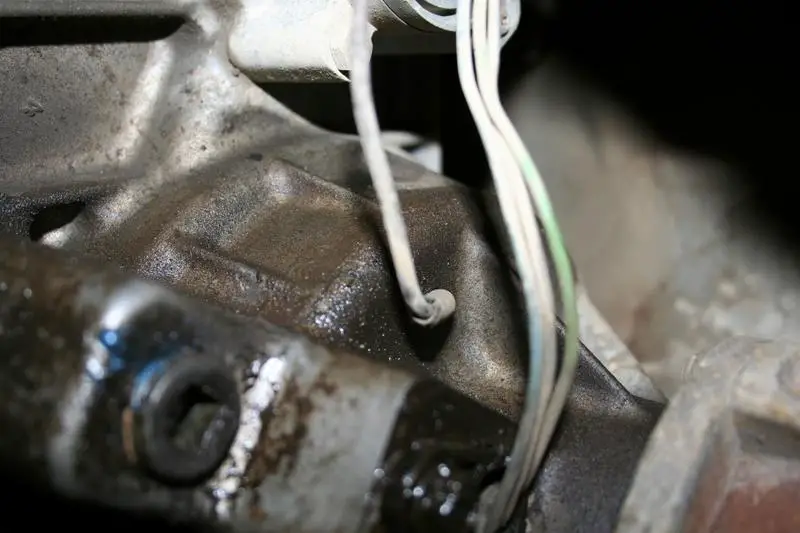

The brown wire is not in the plug, it is alone running into the rear of the case, on the bottom, correct? Will take my camera with me today and get a picture of it......If its still spinning the front you either don't have the right brown wire or your clutch in the transfer box is seized.

I will try this in the next chance I get. It is sitting on the trailer, I have an appt. tomorrow to get it aligned. I live 35 miles or so from town and do not want to drive it that far with it in 4wd, just my luck I would toss the drive shaft. Not to mention with the fried GEM don't want to take a chance. I did take a picture of the brown wire, but have no clue how to post pictures here.There is another option Todd, What if it has actually shifted in to 4high (a problem with the ESCM)?
