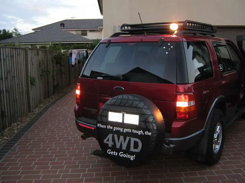

I made a removeable swing away tire carrier for the back of mine. But if you don't want to do that, then the roof is about it.

Got pics? I've been looking around for mounts for our bumpers that could be fabbed to carry a tire, cans, hi-lift, etc.

Yep:
Tyre attached
The mount:
The swing arm:

That looks really good. Did you make it yourself? Got any closeups of the way you mounted the swingarm? Eventually I'd love to have a tire carrier/rack like these (sorry, I'm a converted Jeep guy, so these are what I know, lol):
If I could figure out a way to mount a heavy duty swing-away bracket without losing the bumper cover, that would be ideal. I see a lot of people who replace the entire bumper, but with our GEN3's, that would just look weird. That's the same reason I've refrained from having my metal guy build me a full front bullbar, because IMHO the front bumper of the GEN3's is beautiful, and while I do want better protection up front, I don't want to lose the amazing looks of that bumper. That's why I only have a dinky Manik brush guard right now. If I could find a bullbar that could look just as good as the original bumper, I'd love to have it.

Don't have any close ups of the swing arm mount - but it's currently an 80kg rated gate hinge - I actually need to go to the next size up (130kg) as this one is slowly bending. A clip keeps the hinge from separating, and I have a latch, plus a small D bolt and a padlock to ensure the swingarm doesn't part company with the truck.
The metal bar attached to the bumper is bolted on with 3 x high tensile bolts and then welded as well to the metal part of the rear bar. I had to cut away some of the plastic cover to make it fit. It's done around 5000km worth of trips with no major issues (apart from a slight bend in the hinge bolt.)
As for the skid plate - yes, that's correct, and it is a gas tank, but not the type of gas you are thinking of (petrol); it's an LPG gas tank. The petrol tank is in the normal location under the rear seat on the driver's side (your passenger side, I guess). My Ex runs on both petrol and LPG; got it converted 15 months ago, and had the check engine light on for most of that time, but thanks to James at Henson Performance, I now have an XCal 3 that stops the coding issue!
Back to the swing arm - we only use it on trips away; around town, if we get a flat (hasn't happened yet), I would ring a mate and ask him to come get me and go and get the spare from home. Or ring roadside assistance (I pay for it, so I should get some benefit from it).

That's actually what I was thinking, just mount something to the actual bumper and have brackets come out through the bumper cover. That way I can keep the look of the stock bumper cover, but with some extra beef on the outside, lol.
