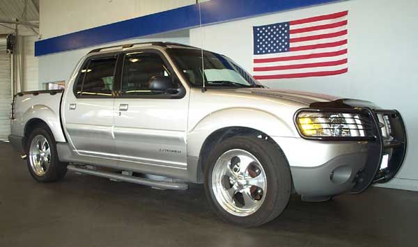

Here is our X-Spec kit installed on a 2002 Sport Trac. Our lowering kits are basicaly the same for X's & S/T's. Vehicles with a production date of 03/02-> require a different kit. We have sold and installed many Sport Trac kits. This vehicle recieved the complete X -Spec Suspension Package.
John V @ Explorer Express
