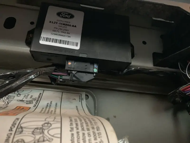

I didn’t see a switch, but this is what’s inside that panel. Tell you anything?
You can just use the regular shocks, either way. It’s unlikely they’d work at this age anyways. Climb under the rear and see if they are just regular shocks.
