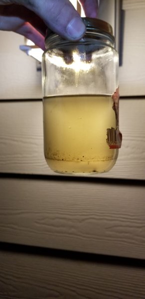

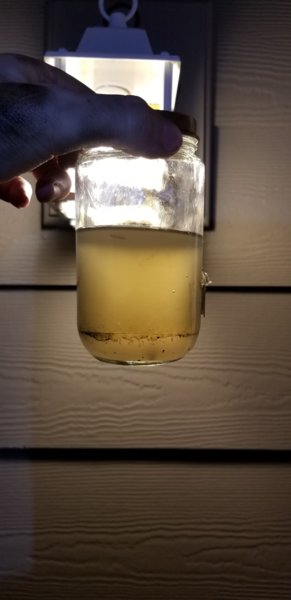

I've got a 93 explorer xlt and it recently started to die on me. It is incredibly random too, it will have a sudden loss of power and then cut out all together. It doesn't do it when there's a heavy load on the engine, normally when it's close to idle. When it does die, sometimes it will start right back up, and other times I will have to sit with it for 1-20 minutes for it to start back up. It'll have a rough idle and fluctuate rpms while it's idling. I just replaced the fuel filter hoping I was having a blockage there, and the gas that drained out doesn't look right, for one it had a bunch of particulates in it, and it also had what seemed like a white sludge or something that settled at the bottom of the glass. I'm thinking from looking at it that there might be water in the gas. Any advice on where to go from here? Can water in the gas cause this kind of stuff to happen? The thing that is irritating to me about this is how random it is and how the severity of it changes. Pictures of the gas are below.
