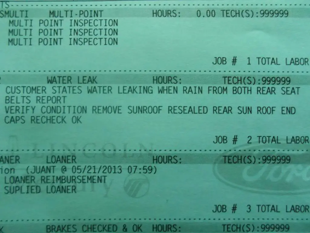

I think its from the roof rails too. when I pick it back up I hope I get to see the tech that worked on it so i can ask him the same question. I dropped it off this morning so hopefully they get it fixed. If they don't I'm due for an oils change in like 2 weeks so ill take it back in. Crossing my fingers again.
Got it back but I didn't get to see the tech.
So it looks like they are contributing the leak to the rear moonroof panel seal. Interesting. I wonder how many owners that have the leak do not have the moonroof?
