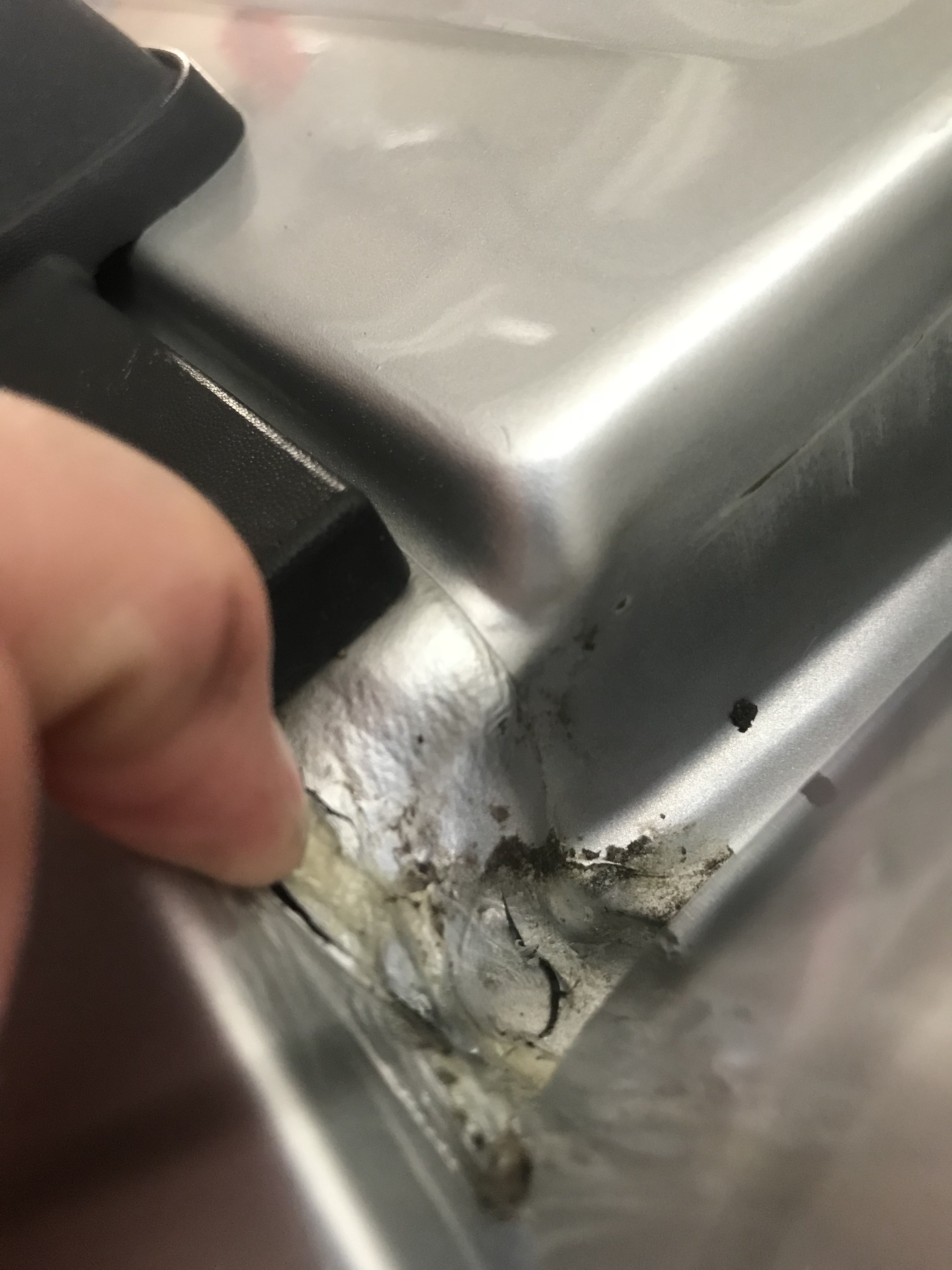

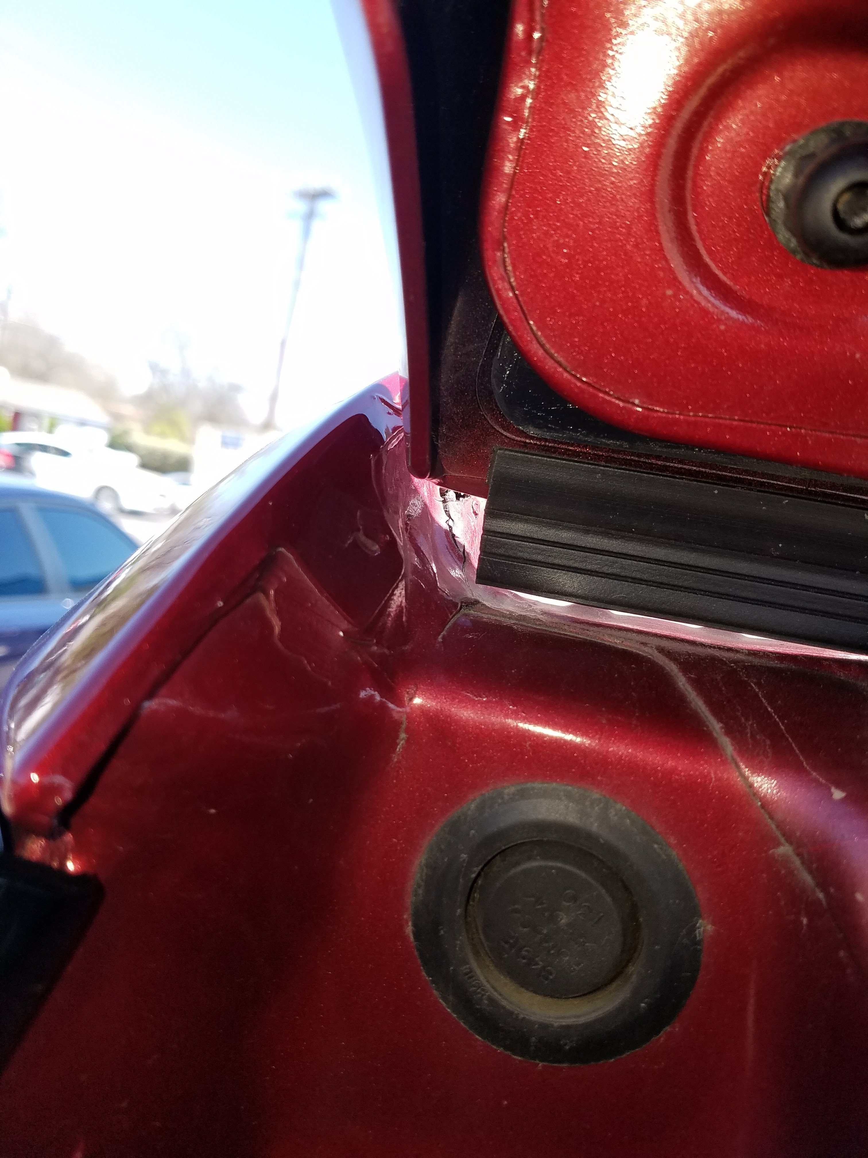

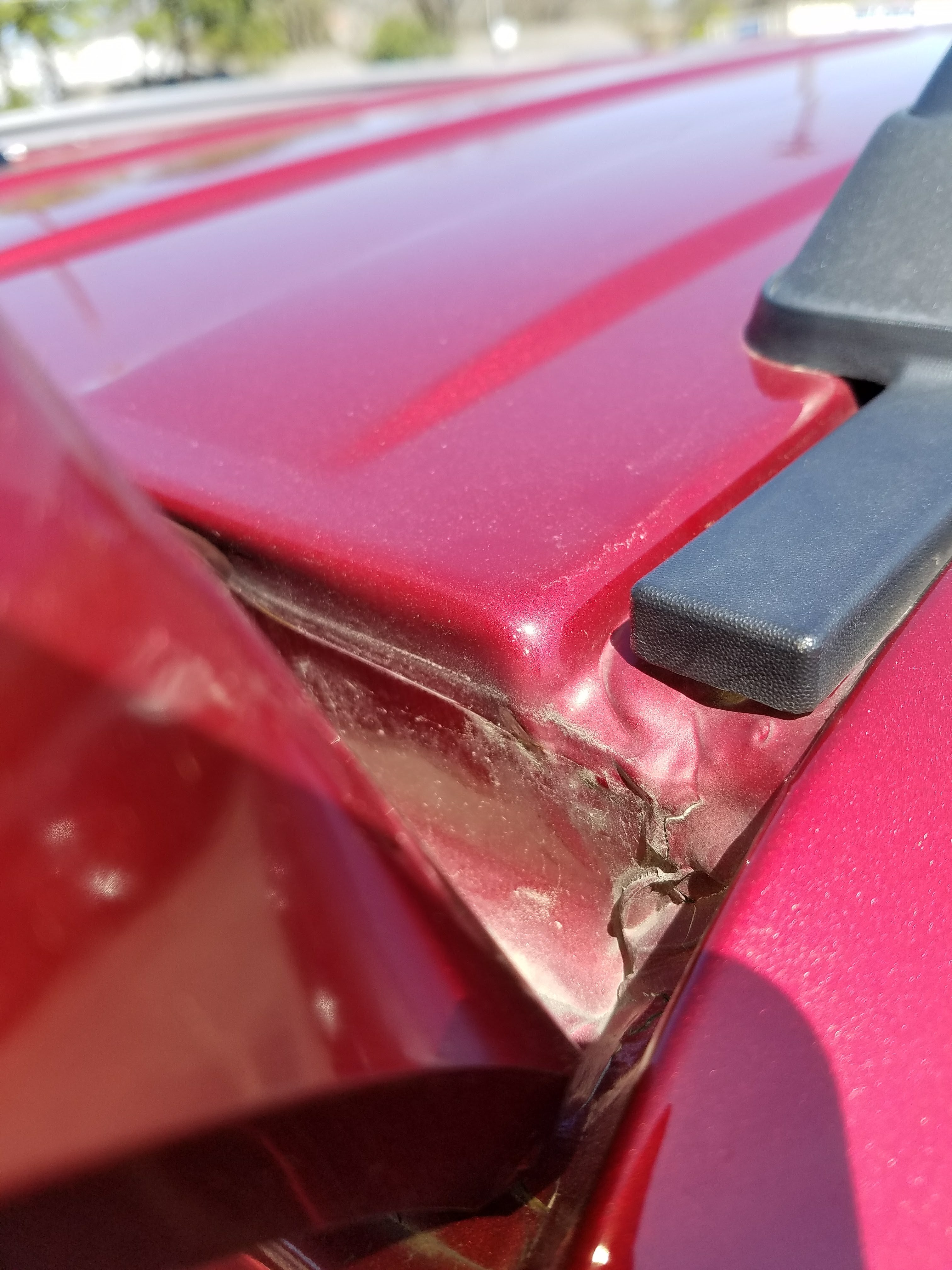

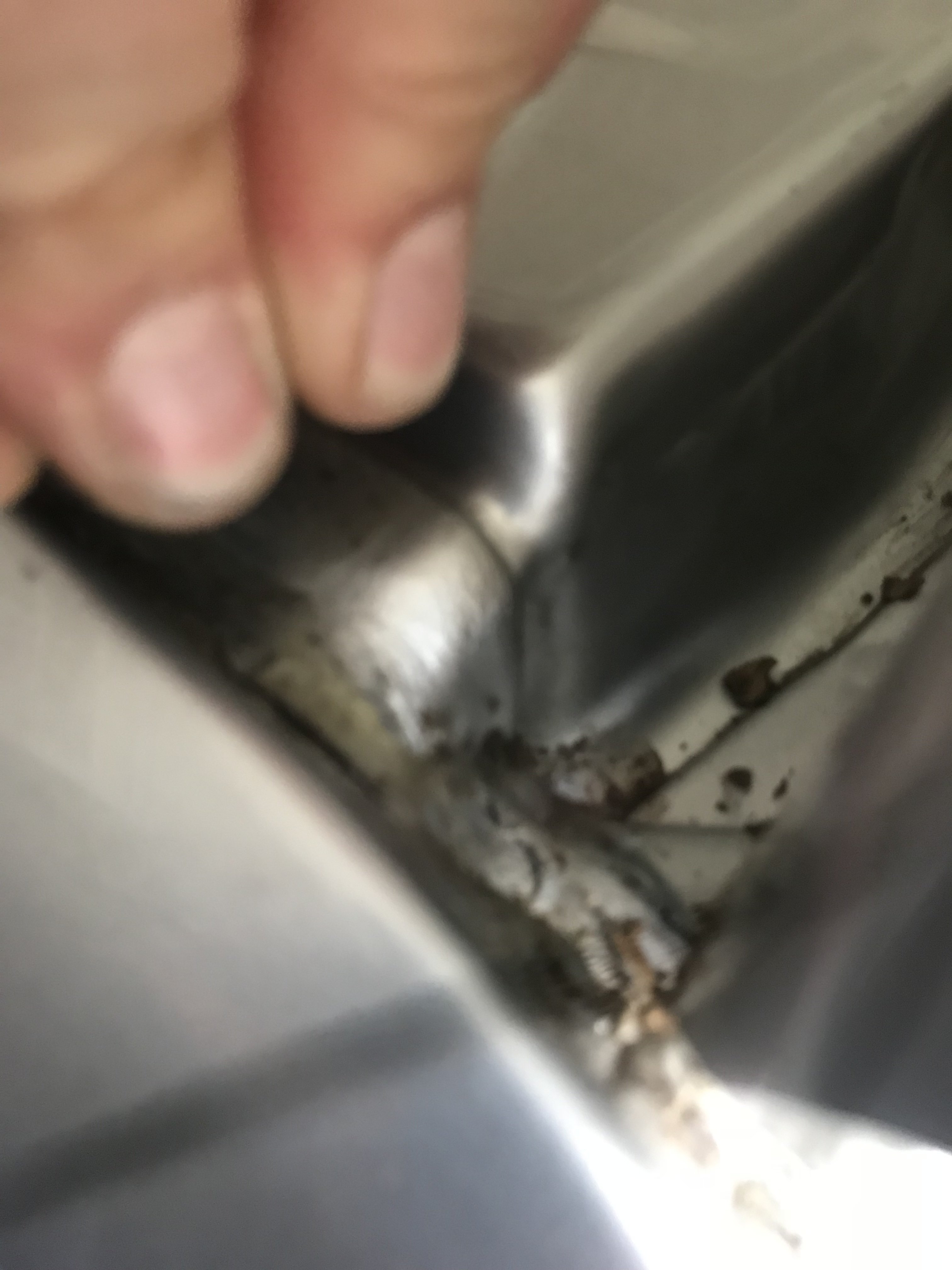

I noticed that, thank you. I haven't had to post pictures of anything in a while but thanks for the info. Seems my cracks are in the identical place as above.i'll get pics uploaded one way or another.
here we go
View attachment 156868 View attachment 156869 View attachment 156870
I had the same issue with my spare tire cover warping which was how I discovered the water in the spare tire area. I noticed the third row seat belts were damp and found the same cracks in the tailgate area just at the end of roof rack channels. The water was getting in there and running down the seat belt (like blwnsmoke references above) into the cargo area. I injected the cracks and glommed the area up with silicone last fall and things have stayed dry throughout the heavy rains and all the melting snow we've had recently here in the northeast.
