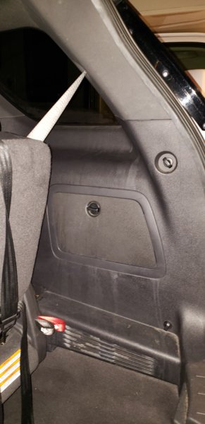

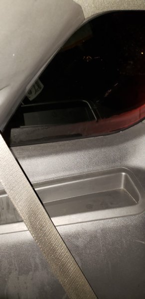

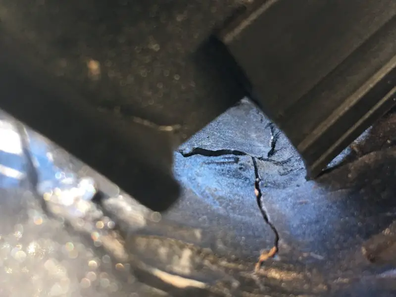

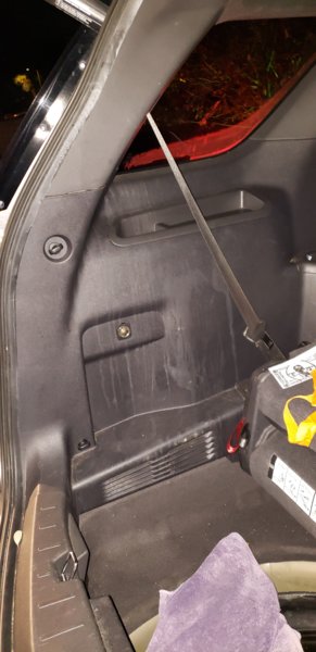

I wanted to know if the Ford dealer will take care of the water leaking from the faulty welds on my 2012 explorer? Has anyone had this issue? What has been done? My car is starting to smell like mildew.View attachment 165528 View attachment 165529 View attachment 165530 View attachment 165531

Welcome to the ForumI wanted to know if the Ford dealer will take care of the water leaking from the faulty welds on my 2012 explorer? Has anyone had this issue? What has been done? My car is starting to smell like mildew.
Short answer is NO. You are on your own. If you check back through this thread you will find there have been several leaks due to weld issues, mainly regarding the liftgate. You will likely find the spare tire well is also soaked.

I can see the cracks where the welds are.How do you know that faulty welds are the issue?

Thanks Peter. No water in the footwell yet.or grab handle. Just the 3rd row and pretty much all of rear.It could possibly be an issue with a moonroof drain tube although that usually results in water pooling in the footwell. There is a post here where a member had water leaking from the passenger 'grab handle'. Water Leak I have asked the member to provide an update if he has one.

I had the same issue it was a crack in the seam at the lift gate bracket and the point where the roof and back panel met. I removed the roof racks and liftgate, sanded the area's where I saw cracks and filled the seam with 3M's automotive seam sealer. I then used painters tape to prevent over spray, primed, painted and used a clearcoat sealer. This was all done 6 months ago and I have not had a problem since. Also when reinstalling the roof rack bolts I used black automotive sealer, similar to what's on your windshield. The bolts may be leaking as well, so don't skip that step.

Hi Lenny - My 2012 Explorer was leaking from rusted bolts on the roof rack. Water presented from right rear seatbelt assembly. It took them a while to determine that - they had to put my vehicle in a rain room before they finally got the correct source of the leak. My dealership and/or Ford Corporate paid for the repair and 3 days rental. Vehicle was at 62,000 miles and it was 3 years and 1 month after I bought it. I didn't have an extended warranty. The bubbling paint on the lip of the hood they only paid 60% of the hood replacement. Recently my plastic trim on left side of windshield went flying off down the road which is another problem that lots of folks report with these vehicles. Make sure you check for bubbled paint around the edge of your hood - galvanic corrosion.
