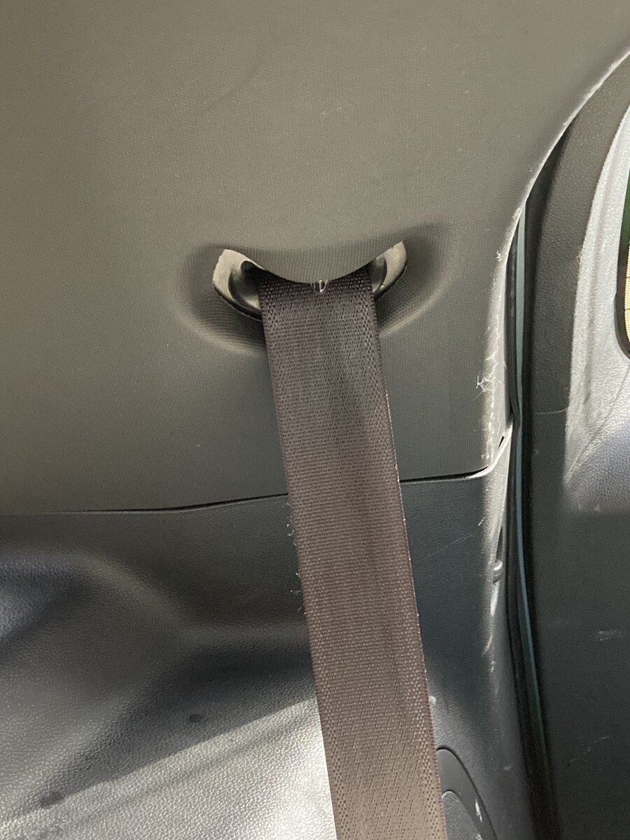

Leaking from 3rd row seatbelts after rain. Anyone else have this problem and solutions?
Your post was moved to this thread. Many members have had this issue and the leak is likely coming from the roof rail mounting point. That and the liftgate seam appear to be the two most common issues. Have you checked your spare tire well for water?

If the water is dripping down the 3rd-row seat belt chances are it is due to a roof rail mount leaking. The other common area is a weld seam on the liftgate as per pictures in this thread. Do you have water in the spare tire well? What has the dealer done in the 2 trips you've made?

Is the water coming down the 3rd-row seat belt? If so, it likely isn't an issue with the liftgate, at least not the bottom. I'm guessing when you say "little black knobs" you are referring to the little 'bumpers' and not the drain holes.
