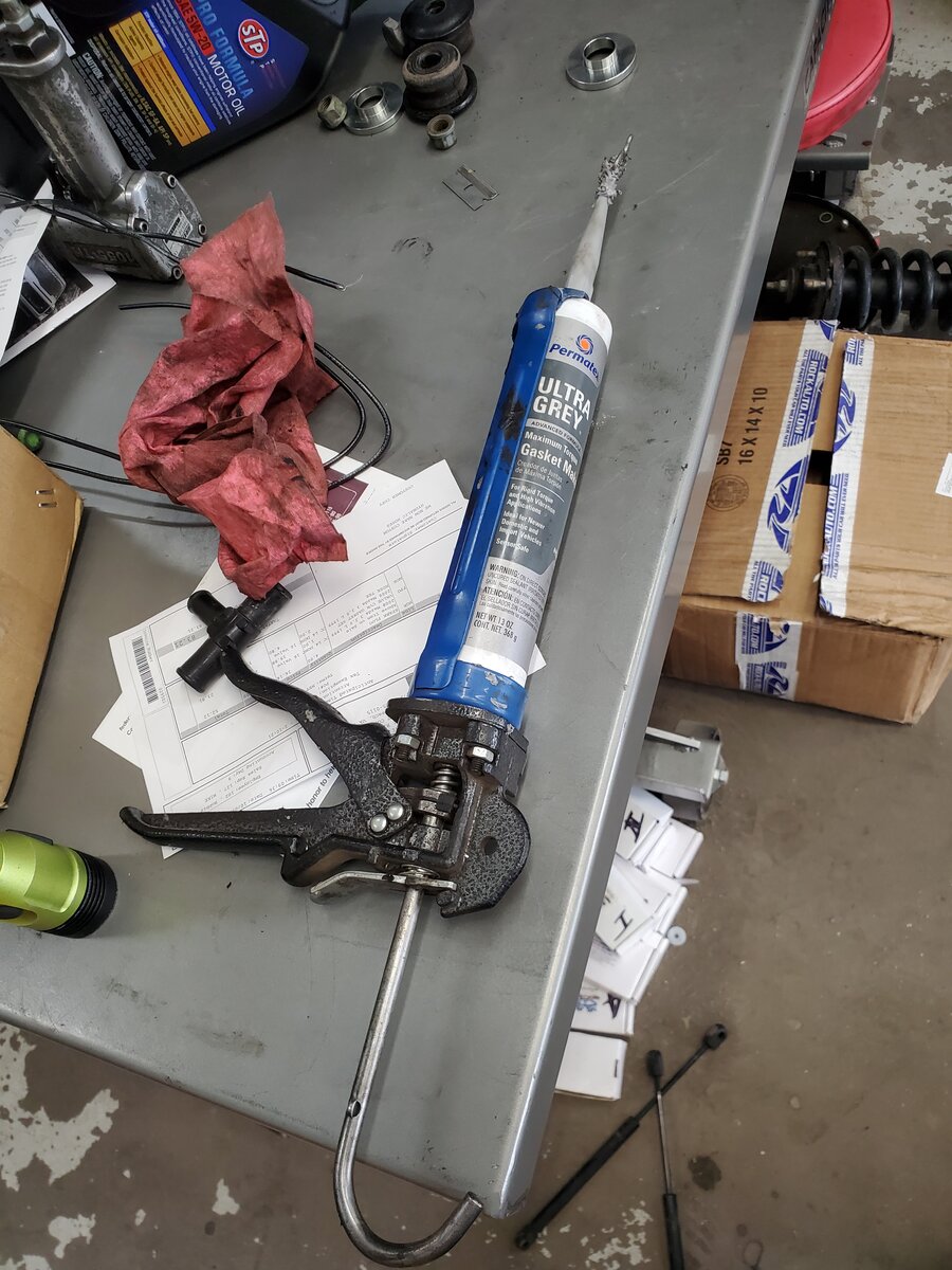

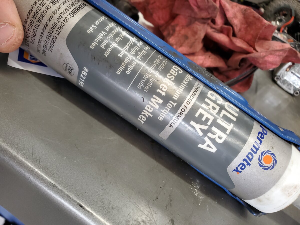

I used ultra black RTV (the super tacky stuff)
You need a silicone gun to use that Ford stuff which is just rebranded RTV these days
I just saw an amazon review with the Motorcraft RTV peeled off, in this case is a Loctite SI 5900. I don´t know if that is what they always use but comparing that Loctite with the Permatex Ultra Black, the Permatex resists 100 F more, so it is better. Thanks!
Ultra grey. It's super strong after it's dry. A regular caulk gun would work, mine is just a fancy one.
Grey is better

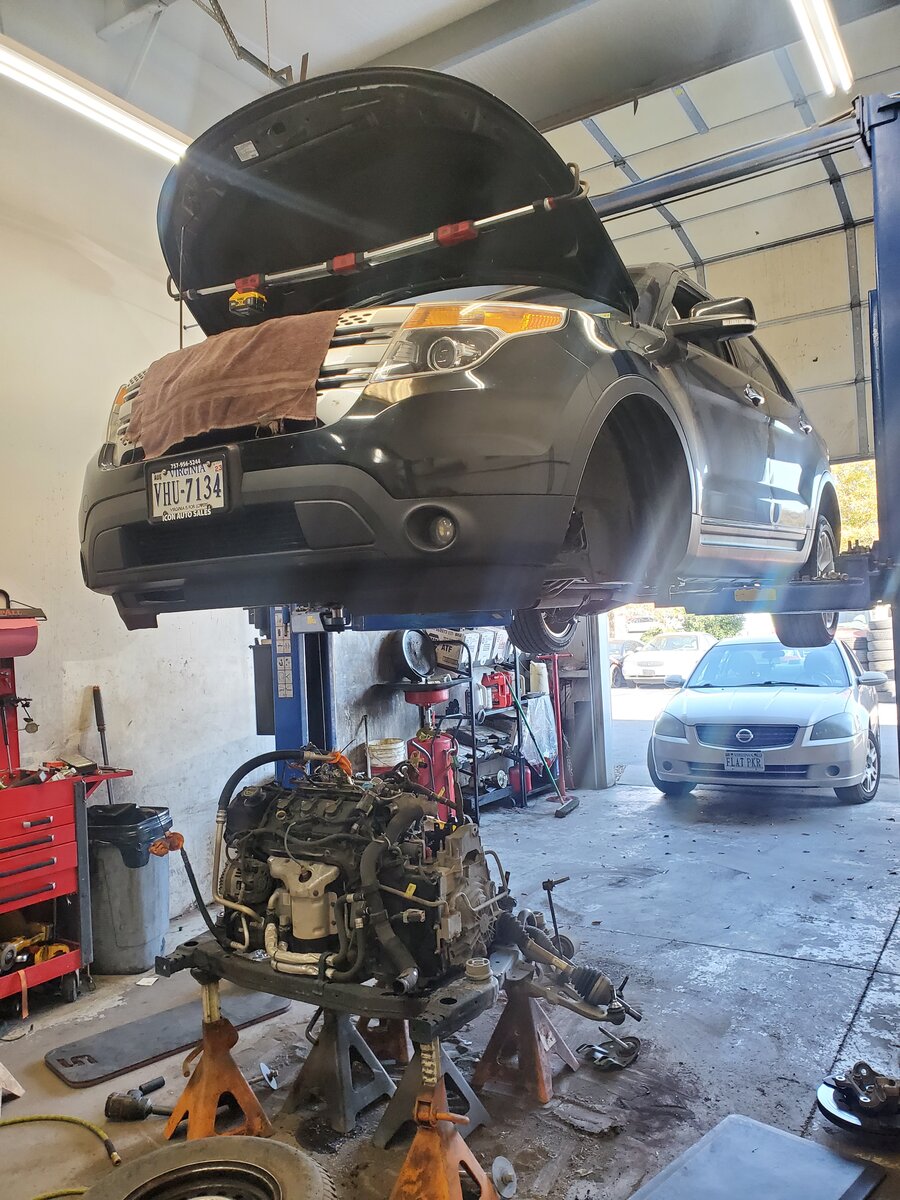

Job finished yesterday, for the moment all went very well. You were right, we had to take off both rear gears (intake and exhaust) and replace 2 bolts from the dealer and follow a 4 steps tightening sequence.
Parts replaced (All OEM Motorcraft)
- Water pump
- Main timing chain
-Valve cover gaskets
- Intake Gasket
- Cranckshaft to timing cover seal
- Chain tensioner
- 2 chain arms (the large ones)
- 2 Chain guides (black small ones)
- 2 Special bolts for the timing gears
- Oil pump
- Thermostat and seal
- Yellow Coolant
Only non Motorctaft:
Mobil 1 5W-20 Advanced Full Synthetic
Permatex Ultra grey Silicone
Engine runs smooth, report back after a few days or weeks. Also report costs after adding up everything.
